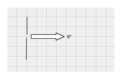

Imagine that you are standing right next to the slits. 0° means you are looking directly away from the slits, perpendicular to the screen that the slits are cut into. If you now turn through an angle greater than 90°, where are you looking? Can the light diffracted through the slits actually travel in that direction? (in the diagram below, the light travels from left to right)
