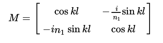

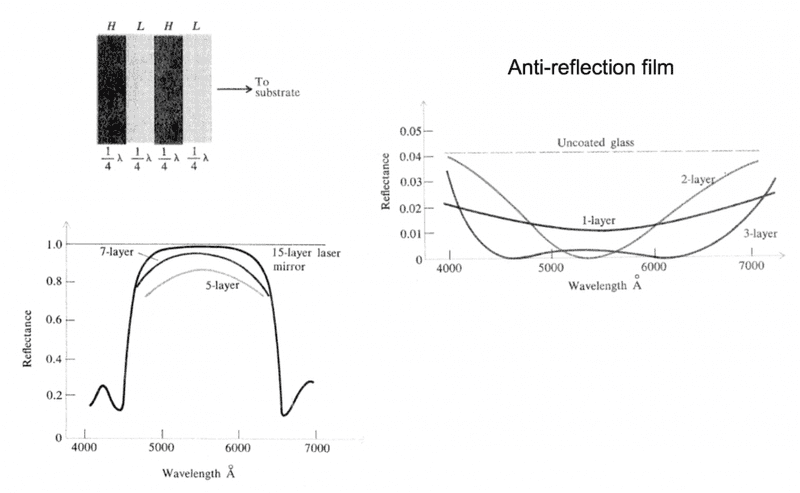

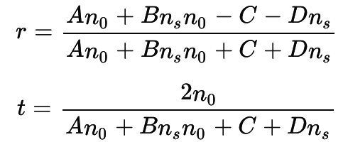

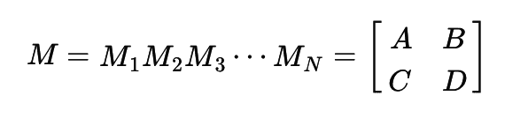

i want to make MATLAB coding which is similar to this program.
--> http://www.filmetrics.com/reflectance-calculator
if i put n layers which is consists of each different n(refractive index), l(length),
then it will calculate M=M1*M2+M3...*Mn, and calculate R. and plot R with wavelength.

tell us what the output is... is it different then desired?
If so how?
