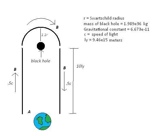

I was wondering how you would calculate the delta-T'(would it be correct to word delta-T' as change in time change?) for this example: (this is not a HW question)
observer A is at earth. observer B fly's 10 light years away at .5c to a non-rotating black hole 1 million times the mass of Earth's star. B does a half orbit around the black hole at a distance of 1.1 times the swartschild radius. During the orbit B increase his velocity to stay in orbit and then returns home at .5c.
how much time has passed for B compared to A on the trip to the black hole?
how much time passed for B compared to A during the orbit?
how much total time passed for B compared to A?
I drew an illustration and put it as an attachment.
This is NOT a HW question. I simply made the example to give some life to the problem. if you don't show how to solve the problem, I won't care. I am really interested in how time dilation is effected by velocity and gravity at the same time. any and all contributions of knowledge or ideas on this subject are greatly appreciated . thanks in advance!
edit: Neglect Earth's gravity for any time dilation.

The way this problem would be solved is to write the Schwarzschild metric and integrate proper time along the space-time path.
Note your object must be under acceleration to keep it from speeding up as in falls into and to accelerate it out of the black hole's gravity well, and also to keep it in orbit that close.
You're going to likely need to integrate this numerically. Using the metric in a curved space-time setting will take into account all effects, velocity and gravitational so your reference is probably fine. I say all effects but there's only one "effect" Different paths through space-time have different proper time components. Some are in flat space-time and you say it's "a velocity effect" some are in curved space-time with zero relative velocities and you say it's "a gravitational effect" but all are "geometric effects".

I assume from your drawing that you mean the object to "orbit" at 0.5c? As seen from Earth?
Working on some calculations:
I think it best to work in c=1 units, convert all distances to light-seconds (Ls).
The Schwarzschild radius of your BH is R=9.85 Ls. So the arc length of your half orbit path is 34.05 Ls.
[tex] d\tau^2 = \left(1 - R/r\right)dt^2 -\left(1-R/r)^{-1} dr^2 - r^2 d\theta^2[/tex]
At r=1.1 R you get:
[tex] 1-R/r = 0.090909,\quad \sqrt{1-R/r}=0.3015[/tex]
For the half orbit at v=0.5 the observer time is
[tex]2\times 34.05 = 68.1 s[/tex]
[tex] d\tau = \sqrt{1-R/r} dt - r d\theta[/tex]
constancy allows simple integration:
[tex]\tau_{orb}= 0.3015 \times2\times 34.05 s - 34.05 s = -13.5s[/tex]
This negative proper time means that your situation is unphysical. Due to the time dilation deep in the gravity well the object cannot travel at what appears to be 0.5c from the observer's (earth's) perspective.
Let's try it this way. Suppose the object travels at speed c.
Then dtau = 0 and 0.3015 dt = r dtheta. So to a distant observer light traveling 1.1R from your black hole is traveling at only 30.15% the speed of light.
In short your problem is ill posed. (Or I made an error. (Or GR is wrong.))
well the wiki did say that the orbit needs to be 3 times the schwarzschild radius? maybe this is why
If you are willing to allow the closest distance from the black hole to be 2 Schwarzschild radii then the object will be traveling at c but appear to be traveling at 1/2 c so you can figure the time difference for that leg to be the full distance=time of flight or 61.9 seconds.
The other two legs will be hairy to integrate if you want exact tangential flights. However going in and then out radially should give a good estimate.
For a free orbit it needs to be 3R out for stability. It will otherwise spiral inward. As you posed the problem I must assume the object is being artificially accelerated by some external force to keep it along your paths at your speeds. So this 3R requirement doesn't apply.
Rather what occurs is that a distance observer watching an object that near a black hole will see an extreme time dilation. They see, for example, light traveling at 30% c as they measure time and distance.
Final remark. I used a crude numerical technique and got about 8.9 seconds more time lost on each of the inward and outward legs due to the BH's effect at 2R.
This is small relative to the 1.4641 years less the object experiences for the two legs (4 year trip) dtau / dt = sqrt(3)/2.
Final Final remark...
An interesting aspect of this problem is that to maintain the 0.5c apparent speed the object will have to be externally accelerated away from the BH for most of the inward leg to keep it from speeding up due to gravity but towards the end it must be accelerated toward the BH to overcome the increasing gravitational time-dilation in order to appear to be traveling a constant 0.5c from the distant observer's point of view.
Now that's an interesting calculation. What is the acceleration the object experiences so as to keep it at this apparent 0.5 c velocity?
