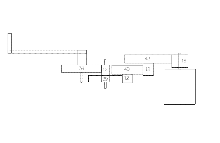

Hi , is anyone studying gear ratios??
i need some help with calculating the final gear drive..
i've calculated it at 94.97:1
is this correct??
What are these numbers, diameters, radius, number of teeth?
they are number of teeth.
Do you want to know what's the end torque? Because without radii, I can't tell you.
Follow the train through logically. Starting at the motor:
Gear 1 to 2: The speed will step down by a factor of 6/43.
Gear 2 to 3: The speed should stay the same since they are on the same shaft, so it's ratio could be 1/1
Gear 3 to 4: The speed is reduced again by a factor of 12/40.
Gear 4 to 5: Again, they are on the same shaft so the ratio should be 1/1.
Gear 5 to 6: There is another reduction in speed by a factor of 12/39.
Gear 6 to 7: Same shaft, no change, 1/1.
Gear 7 to 8: A final reduction in speed of 12/39.
So where does that leave you?
94.62 : 1 thanks fred ..
how did you know it was a motor :wink: :smile:
