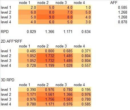

For example, see this example core with 4 axial levels and 4 assemblies. Using the 2D synthesis does not produce the correct 3D nodal power.

QuantumPion said:
For example, see this example core with 4 levels and 4 nodes. Using the 2D synthesis does not produce the correct 3D nodal power.
I am extremely sorry that I could not follow the figure properly!
1. In the first table, how have you calculated AFF and RPD?
2. How can we calculate 3D RPD for the 3rd table?
Thanks again!

1) AFF is the ratio of the average of the axial level compared to the core average. RPD is the ratio of the average of the assembly to the core average.
2) 3D RPD is the ratio of the individual 3D node to the core average (note I should have labelled the columns "assembly x" instead of "node x" to avoid confusion).
