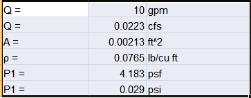

I also attempted to use the fluid momentum equation which gave me approximately .06 psig but I was very unsure about the validity of this principle in this particular situation. I was also able to use water that had a flow rate of 7 gpm and determine the pressure experimentally and it was about .75 psig. I assume this is very similar to the number I would get with the gas except the gas would create less pressure because it has a lower density.
Using my above equation and units, my result for air is:
