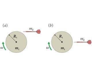

A dart of inertia md is fired such that it strikes with speed vd, embedding its tip in the rim of a target that is a uniform disk of inertia mt and radius Rt. The target is initially rotating clockwise in the view shown in (Figure 1) , with rotational speed ω about an axis that runs through its center and is perpendicular to its plane. Assume that the dart's inertia is concentrated at its tip.
What is the final rotational speed of the target if the dart strikes tangent to the target rim as in the figure, case (a)? Enter positive value if the rotation is counterclockwise and negative value if the rotation is clockwise.
What is the final rotational speed of the target if the dart strikes normal to the rim as in the figure, case (b)? Enter positive value if the rotation is counterclockwise and negative value if the rotation is clockwise.
Two diagrams of a uniform disk of mass m_t and radius R_t spinning with angular velocity ω, with a dart of mass m_d approaching its rim: (a) tangent to the rim, (b) normal to the rim.

xxphysics said:
I'm assuming energy equations?
As a matter of principle, you should not appeal to conservation of mechanical energy unless you have a good reason to believe it is conserved. Since there is an impact here, it quite likely is not conserved.
What other conservation laws can you think of that might be appropriate?

Conservation of angular momentum ? L = Iw

That's a distinct possibility. What is the criterion for that to be conserved?
(A) We can solve this problem using conservation of angular momentum. The dart has some amount of angular momentum with respect to the axis of the disk. When the dart strikes the disk, it adds that angular momentum, and also increases the rotational inertia of the disk.
Initial Momentum: md * vd * R - 1/2 * mt * Rt2 * Omegai
Final Momentum: (1/2 * mt * Rt2 + md * Rt2) * Omegaf
Set the final and initial angular momenta equal to each other and isolate Omegaf
(B) In this case, the dart’s initial angular momentum about the disk’s axis is zero.
So same equation, but the initial angular momentum for the dart this time is zero.
