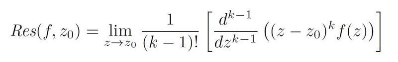

I know that the residue of a function with a pole of k-th order is given by this:
Formula for the residue of f at z0 of order k: Res(f, z0) = lim as z approaches z0 of (1/(k-1)!) times the (k-1)th derivative with respect to z of (z - z0)^k f(z).

You got them k's in there representing two different things, one of the worst things you can do in math. The formula for the residue is in terms of the order of the pole given as k. Me, I'd change the pi thing to [itex]n\pi[/itex]. Ok, got that straight. Now what is the order of the pole? How you know it's third order or k=3? Do that later. Let's assume it is for [itex]n\neq 0[/itex], then by your formula, we could write:
[tex]\text{Res}\left(f(z),n\pi\right)= \lim_{z\to n\pi} \frac{1}{2}\frac{d^2}{dz^2}\left\{(z-n\pi)^2 f(z)\right\},\quad n=\pm 1, \pm 2,\cdots[/tex]
