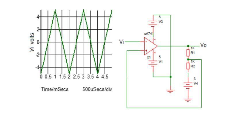

Hi,
I need to calculate the threshold voltage for an op amp circuit.
I am given "The maximum output voltage swing of the op-amp is ± 3 V for when the supply is ± 5 V."
Would this mean that I should calculate the upper threshold voltage as 8V and the lower threshold at 2V?
I have added an image of the Waveform and circuit I am using.
Thanks
  • Left: a plot of Vi in volts against Time in mSecs, a triangle wave swinging between about -4.5 and 5 V over 5 ms with 500 uSecs per division. Right: a uA741 op-amp schematic with V3 and V1 at 5 V supplies, feedback resistors R1 and R2 at 1K, V4 at 3 V, and input Vi and output Vo.

Enochfoul - having a look onto your circuit, I see an opamp with positive feedback.
Question: Do you know what such a circuit does? Is it an amplifier or something else?
You must know and understand the function of the circuit - without that you will not be able to know the meaning of "threshold voltage" for THIS kind of circuits.
This is a comparator which is a decision making circuit that makes use of an operational amplifiers very high gain in its open-loop state. It compares one analogue voltage level with another analogue voltage level.

Be more literal.
Where'd you get 8 ?
IF the opamp has only 5 volts available to it, how can it make its output go beyond 5 ?
Most opamps need some "headroom" between supply and output. There exist special ones that do not, they are called "rail to rail " . 741 has been around since 1967 long before rail-to-rail came about.
So its output can only approach ±5, and they're telling you how close it can come.
Taking them at their word they say your 741 needs 2 volts of headroom, look again at your quote above.
Yes - that is correct.
Now - based on this description - I think the meaning of the term "threshold" is clear. When the input voltage reaches a certain value something happens. More than that, because of the positive feedback (a kind of memory) it is important if the input voltage is approachng this "certain" value from higher or lower voltage levels.
Further comment: I think, it is not necessary to further discuss opamp 741 properties and other rail-to-rail questions. The task requires to consider +- 3V as output limits. That`s all.

I wonder if it would help Enochfoul to think what the output is for the given triangular wave input? Then to relate the two graphs.

I think you mean half of these values?
It's sufficient to have a basic idea of what you'll be needing the comparator to do, so don't worry about the exact values of the threshold levels at this stage.
What you need first is to determine some design equations for the circuit: you need equations relating each threshold voltage to circuit parameters such as R1, R2, V4 and the OP-AMP's ± output (max). Have you studied this type of squaring circuit in your course?
