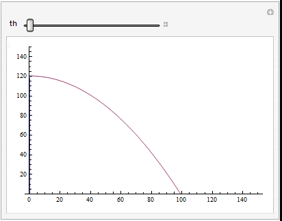

From
x = vo(cosθ)t
y = yo + vo(sinθ)t - (1/2)gt2
you can eliminate t and get the trajectory y as a function of x for a fragment thrown out at angle θ.
As mentioned in post #13, you can now fix x and vary θ to maximize y at a fixed distance x. I believe this should give you ymax(x) which will be your envelope curve that you can then rotate around the y-axis to generate the surface that encloses the volume above the ground.
Carrying this through and finding the volume did not seem too difficult, unless I overlooked something.

I don't follow. After solving the equations for the envelope curve, I made the attached animation which shows that it does appear to envelop the trajectories.
Very cool. I clearly mis-thought what happened to the envelope as the pieces went above the point of the explosion.
What tool did you use to make that animation?
I used the "Manipulate" command in Mathematica to create the animation. I exported the animation as an avi file and then used another program to convert the file to an animated gif.
