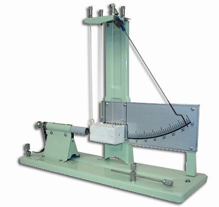

I'm looking for the ballistic pendulum velocity for a simple machine (pull back lever, it shoots a marble into a block that raises to a certain degree measured)
I have the angle that the block is raised
length of the string
mass of block
Ke=Pe (1/2MV^2=MGH)
cos@=length of sting - height/length of string
.20cos25.3 = .20 - h
which gives me .02cm, which in turn gives me .6m/s, which seems a bit slow, I feel as if I'm messing up my trig but I don't know where...
I figured out I was using an incorrect derivation, I was just so fixed on thinking I had messed up my trig work

I've been given the manufacturers velocity, which is 5.5m/s, I'm getting less than 1m/s and honestly I don't see what I'm doing wrong.
BTW here is the pendulum I used:
What exactly is this:
V = Rad(9.8 * 0.2)/0.5
Ke=Pe
1/2mv^2=mgh
masses cancel, divide both sides by .5
take the square root of both sides to get v=rad(GH)/.5
Just your notation--rad is confused with radians. \sqrt{} is available on the latex option on advanced setting with the icon:\Sigma Or simply denote as sqrt(gh/.5)
