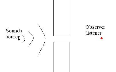

Ok so I was sitting out back one day listening to some music with some friends around.
We had some music playing on a stereo inside the house and we were out the back with the glass door open about 10 cm's.
I thought I noticed that some sounds with different frequencies seemed louder then other sounds with noticably different frequencies. So i suggested that perhaps the wavelength of some of the sounds with frequency x, was making it through the small gap whereas another sound at the same instance with wavelength and frequency y was not making it through the small gap.
Is this correct?

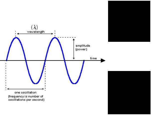

It sounded correct but the more i think about it the more complex it becomes. I cannot imagine a sound wave propagating through 3-dimensional area and where the amplitude comes into effect. I understand how a soundwave is simply compression of air and the distance between two compressions is the wavelength BUT where is the amplitude?
Would a gap smaller then the wavelength effect the intensity of the sound you are hearing or since the wavelength travels longitudinally then the gap would not effect it?
What about amplitude. If the amplitude is of a greater distance then the gap then would the resultant intensity become lesser then a sound with smaller amplitude then the gap?
Ignoring any sound coming through the barriers of course and think theoretically.
You could set up an experiment to emit sounds of differing frequency and amplitude to try and see if the gap effects the resultant intensity of the sound (if a soundwave travel through the gap un-hindered then it is going to be louder then a soundwave that hits the barrier and travels through that)
Its a slit experiment but in 3-dimensions;

I found a definition of amplitude of sound waves and all it is is the "maximum change in position of the particles that make up the medium"so it is really just the amount the air molecules in the case are compressed.
So i think the answer would be that neither the wavelength or the amplitude would effect the intensities... Rather it would just be like a regular wave like interference pattern?
From your picture, the higher frequencies should be louder, because they aren't diffracted as much as the lower frequencies. If you move laterally away from the opening (i.e. your observer is off-axis from the gap), the lower frequencies should be louder.
Here is a website:
http://hyperphysics.phy-astr.gsu.edu/hbase/sound/diffrac.html
If you do not observe this behavior (i.e., the lower frequencies are louder to you), let us know so we can try to figure out the reason.

That website was great and its obvious now that the higher frequencies where louder and any lower ones where the ones that i thought were less intense. This is why i initially thought that it was wavelength that was the factor of intensity because the higher frequencies had smaller wavelengths that i mistook as being able to squeeze through the gap.
