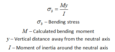

Suggest why a thin rod can bend more than thick rod without breaking
A thin rod bends more easily than a thick rod due to the relationship between stress and strain as defined by the equation F/A, where F is the force applied and A is the cross-sectional area. For the same bending angle, the stress in a thinner rod is lower because the tensile strain is reduced, which is influenced by the distance from the neutral axis. The maximum bending stress in a thicker rod is greater due to its material elements being positioned further from the neutral axis, leading to a higher likelihood of breaking under the same force. Thus, the bending behavior of rods is fundamentally linked to their geometry and material properties.

Faiq said:Suggest why a thin rod can bend more than thick rod without breaking
M/I is the same thing as the elastic modulus E divided by the radius of curvature. So as I said in my post, for the same radius of curvature, with two rods of the same material, the thicker one will have a larger bending stress because it has material elements further from the neutral axis.DanielSauza said:Because the bending stress depends on the distance between it's neutral axis (which is in the center for common shapes in the case of pure bending). So a thicker rod will experience larger maximum bending stress than a slim one when subject to forces of the same magnitude.
