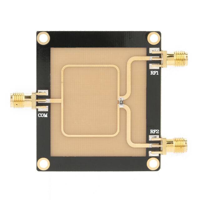

It's double the power, 3dB, minus any circuit losses
It's a very common thing to do in amplifiers by combining the output from multiple modules/devices
A simple PCB one ...
It's also a very common thing to do with different spot frequencies within the same band, used in repeater systems
A combiner is used for this purpose which matches the 2 incoming 50 Ohm ports to a single 50 Ohm output port
A combiner can be used in reverse to become a divider, say 1 input to 2 output ports. eg when one coax feeds 2 antennas
Only if the impedances are right and if a circuit such as the one you illustrate. Two 50Ohm sources, connected in parallel will be the equivalent of a single 25Ohm source and the same source Volts. The ratio of powers, delivered from an emf of V to the 50Ohm load is 1/4 : 4/9, which is 1.78 times the power delivered from a single source. That's not as good as the X2 that a properly matched network will give you. There's a shortfall of about 0.5dB. There are other problems with that simple connection as there can be a mismatch, seen by each of the generators and the load (on the end of a feed line). Your system is much better in many ways.
Edit: all this applies when the two sources are the same frequency and in phase. If you are trying to combine two different transmitters on different channels into one antenna feed then you need to have 'notch' filters `( or equivalent) so that each transmitter feed appears as an open circuit at the operating frequency of the other. When you're dealing with tens or hundreds of kW, Power loss can be a major issue but the technology has been used for many decades. Hats off to the RF Engineers of the past who had to make do with very basic measuring equipment and no computers to help them.

I believe Davenn assumed that the sources were connected using a combiner/splitter (it the same typically the component) which will provide isolation between them and ensure that everything stays at 50 ohm
Connecting two sources directly (via say a BNC-T) is usually a bad idea; and I would never try it using an actual RF source. There is real risk that you could damage the output of the sources,
At the very least I would include some protection by adding some resistors in series with each source; this won't help the RF performance but will reduce the risk of damage.

There are a number of resistive combiners but they always waste power. Favourite is a 3dB coupler which will give all the combined powers of two identical sources out of one port and any imbalanced power out of the fourth port - which you would normally terminate with 50Ohms. There are many designs of 3dB couplers. I remember Sage Wireline which could be cut to length (λ/4). I don't know if it's still available but a cheap solution if you don't have good PCB making facilities.

I'm going to nitpick:cool: here and point out that what you are describing is neither a coupler nor splitter, but a 3dB hybrid (if I understood the description correctly)
Splitter/combiners (3 port device) , hybrids (4 ports) and couplers (usually 4 ports, but one port is typically terminated at the factory) and all be used to "divide" signals; but they work somewhat differently and if you buy one you need to make sure it does what you want.

My comment above was not meant as criticism. It is just that it usually better to use purpose made splitters instead of hybrids. Splitters are usually cheaper and have wider bandwidth.
If you are working at low frequencies (up to a few hundred MHz) you can buy cheap splitters from places like Minicircuits.

Splitters/combiners can cover more than an octave. The ones I use in the lab typically cover 2-18 GHz (I mostly work between 3 and 10 GHz, but sometimes it is good to be able to go to higher frequencies).
Typical insertion loss (in addition to the 3 dB) is something like 1dB which is a bit higher than ones that only cover a decade (which have insertion losses of about 0.4 dB or so) but the isolation is still close to 20 dB and that is usually the most important parameter

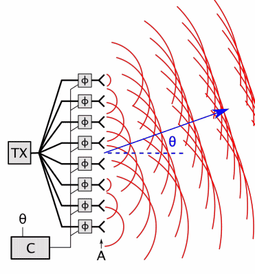

If the OP is searching for an analogy from basic electronics to teach and/or better understand RF, consider visual waveform representations rather than 'parallel direct current' models. Even pulsed DC analogues leave out vital details.
Before personal electronic computers became common, I often found Lissajous figures helpful teaching beginning RF including comparator circuits, RF mixing, signal conditioning and parametric oscillators/amplifiers. The latter intrinsic parametric equations also serve as introduction to understand masers and antennae designs.
For measuring small changes between your two input waveforms consider using Moire patterns as an analogue for wave interference; again, a highly visual representation of interpenetrating fields.
In keeping with your antenna model, simplified visual representations of phased array radar systems may offer guidance. Perhaps the expanding radiation wave front in this excerpted illustration might serve as a replacement model for DC voltage amplitude? Or am I over complicating the question?
I concur with prior comments that 'wave' and beam models help students visualize and then manipulate RF electromagnetic fields. Also agree that understanding impedance, particularly distributed impedance, remains vital to understanding RF circuits and systems; justifying the additional comments concerning impedance matching and coupling components.
