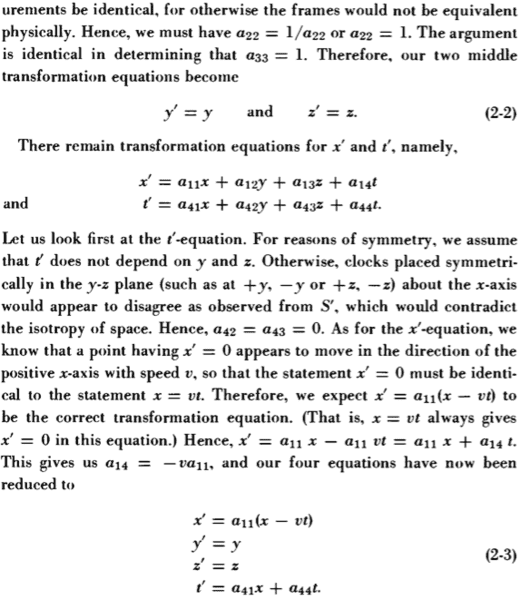

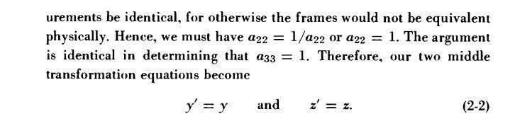

Printed page of text from a physics textbook showing the equations y' = a22 y and z' = a33 z, followed by a paragraph deriving a22 from a rod of unit length along the y-axis.
Printed textbook page text deriving the transformation equations y' = y and z' = z, concluding a22 = a33 = 1 from symmetry of the two frames, labelled (2-2).

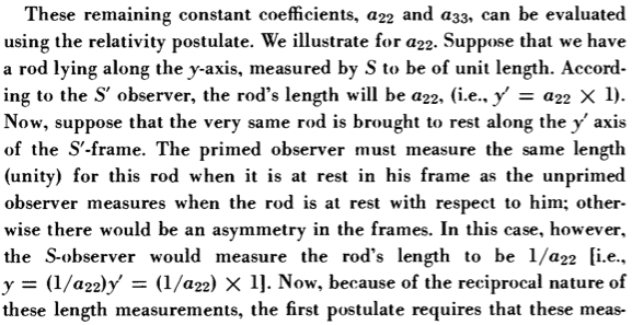

Suppose we have a rod of unit length placed stationary in frame S. According to an observer in frame S' (which is moving at a velocity v relative to frame S), this rod is moving and its length would be ##\frac{1}{\gamma}## (i.e., ##\Delta l'=\frac{\Delta l}{\gamma}=\frac{1}{\gamma}##).
Following the above argument, we now place the rod stationary in frame S'. The rod must also be of unit length in frame S'; otherwise there would be an asymmetry in the frames. In this case, however, the S-observer would measure the rod's length to be ##\gamma## (i.e., ##\Delta l=\gamma\Delta l'=\gamma\times1##). Now, because of the reciprocal nature of these length measurements, the first postulate (see below) requires that these measurements be identical, for otherwise the frames would not be identical physically. Hence, we must have ##\gamma=\frac{1}{\gamma}## or ##\gamma=1##.
But for non-zero v, ##\gamma\neq1##. Hence, I don't understand the above argument fully.
Of course, I know my argument involving ##\Delta l## is wrong. What I don't understand is why the argument works for ##y## but not for ##\Delta l##.

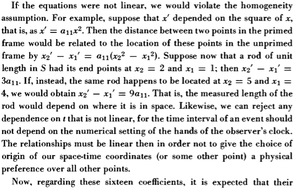

These are the relevant pages.

PeterDonis said:
Which doesn't apply if the rod is oriented along the direction of motion.
I know the argument doesn't apply if the rod is oriented along the direction of motion, because I know the Lorentz transformation equations are true.
But since the text in these relevant pages is trying to derive the Lorentz transformation equations, it cannot and does not assume the Lorentz transformation equations to be true beforehand. Yet, without first assuming the Lorentz transformation equations to be true, I do not understand why the argument applies when the rod is oriented perpendicular to the direction of motion but does not apply when the rod is oriented along the direction of motion.

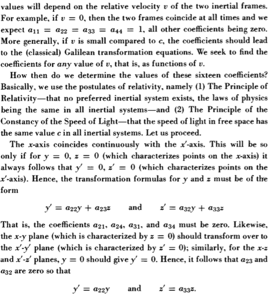

You might want to consider the step leading to ##y'=a_{22}y+a_{23}z## and the similar expression for ##z'##.
So basically in order for the x-axis to continuously coincide with the x'-axis, the coefficients in y' and z' that multiply the x and t coordinates must be zero?
Also wouldn't a23 and a32 have to be zero as well?
The argument about the ##a_{22}## coefficient applies because ##y'=a_{22}y##.
The equation relating ##x'## to ##x## doesn't take the same form, so there is no same argument to be made.
Yes.
Not for the x and x' axes to coincide. That simply requires all points (t,x,0,0) to map onto (t',x',0,0). For example, if the y' and z' axes are rotated with respect to the y and z axes the x-axis still maps on to the x' axis.
The next paragraph makes additional arguments leading to ##a_{23}=a_{32}=0##.
