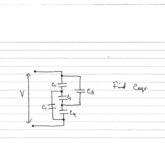

Finding the equivalent capacitance of the supplied circuit.
For parallel capacitors, C EQ.=C1+C2+C3+..
For serial capacitors, 1/C EQ.=1/C1+1/C2+...
The circuit simplification is difficult!
Here, Look at this diagram I drew for you.
It is actually the same circuit.
What can you say about the various potential differences?
Also, take note that the C=Q/V. Over here, C is specified, V and Q are unspecified. How can you make this property useful?
Thanks! Just tell me one thing, can C3 be ignored because it carries no charge?
That would be the case if all the capacitors except C3 have an equal capacitance. The potential difference between b and e in the diagram will be 0 and so no current will flow through C3.
The circuit will then be simpler.
And yes, C3 is ignored provided whatever is above is true.
