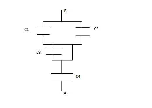

Calculate the capacitance between A and B in the attached diagram.
(Capacitor.png)

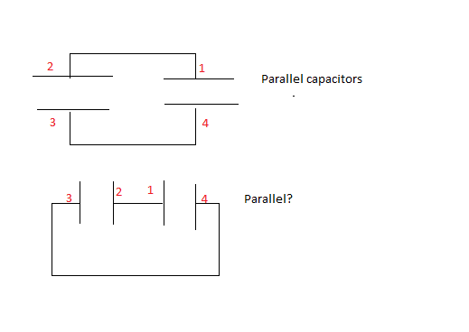

I just want to clarify something in my book first: The definition for capacitors in parallel is given as 'the capacitors are directly wired together at one plate and directly wired together at the other plate..' So something like in the top picture of (Parallel.png). However, with the definition given, I can also draw the bottom picture of Parallel.png which means (according to that definition) that system is also in parallel. This does not seem right because there is only passage for charge through the circuit. Is the definition in the book a little vague or did I miss something?
Many thanks.

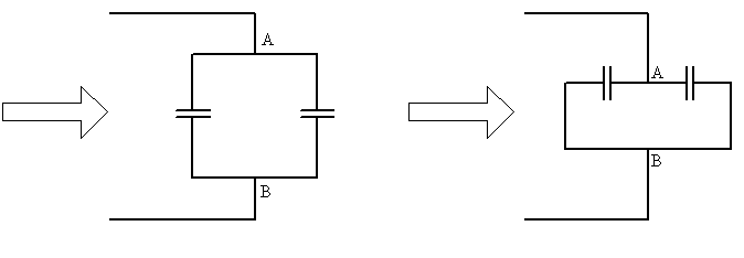

If the whole circuit just has two capacitors in a circle, it is pointless to distinguish between parallel and serial capacitors.
With just two components, it can be ambiguous as to whether they should be considered as being in series or in parallel. Both views are valid.
Ambiguity is removed when you specify how you are to "look" at the circuit for measurement purposes. Once you choose the "viewing port", the ambiguity is resolved:
the battery was implicitly there as well. When you say 'pointless', do you mean you cannot say whether it is a series or parallel or that you can, but there is no reason to?
Edit: gneills post cleared that up.
What do you mean by 'viewing port'? By showing the junctions? Could you explain how the ambiguity is resolved? If I were to move the capacitors in the left picture up along the wire then I would have exactly the same diagram as the one on the right.
The ambiguity is resolved by specifying how the combination is viewed externally. In the diagram, the added leads are where you'd measure voltage, inject current, etc., and between which you'd measure the capacitance.
Exactly! No ambiguity. They are the same when viewed from the external connection wires.
If there is no external framework by which to judge the connection, then you can choose to consider them to be either in series or in parallel.

In the attached circuit, I said that C3 and C4 are in parallel so the effective capacitance there is C3 + C4. Then C1 and C2 are also in parallel so the effective capacitance is C1+ C2 there. These two capacitances are in series, so I then add the reciprocals to obtain: $$\frac{1}{C_T} = \frac{1}{C1+C2} + \frac{1}{C3 + C4} = \frac{C3+ C4 + C1 + C2}{(C1+C2)(C3 + C4)} $$
The values of C4 = 150, C3 = 50, C2 = 100, C1 = 200 all in microfarads. Substitute in and I get ##120\mu F##, which is 20μF over the suggested answer.
If the attached circuit you're referring to is the first one from the initial post in this thread, then it appears to me that C3 is bypassed (shorted) by a wire, so it effectively disappears from the circuit.
Shorted by the wire on the right (the wire parallel to C3)? If so, then surely the current would split at the junction right after C4?
Yup.
Sure. Why don't you redraw the circuit without C3.

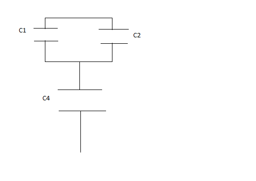

It would be equivalent to this circuit:
Yes (although it's missing the top lead for the "B" connection).
Can you determine the net capacitance between the top and bottom nodes (B to A)?
Yes and that gives me the required 100μF, however, I am still a little unsure about why exactly C3 is shorted out? Why is this the case? (I can see the wire parallel to C3 that shorts it but when the current splits at the junction ahead of C4, then some would surely accumulate at C3 ?
Any capacitor has some equivalent resistance. When one is in parallel with a zero-resistance wire, how much current would flow through the capacitor?
The shorting wire ties both leads of C3 together, making it a single node. By definition a single node is all at the same potential. That means there can be no potential difference across the capacitor, hence no charge can accumulate.

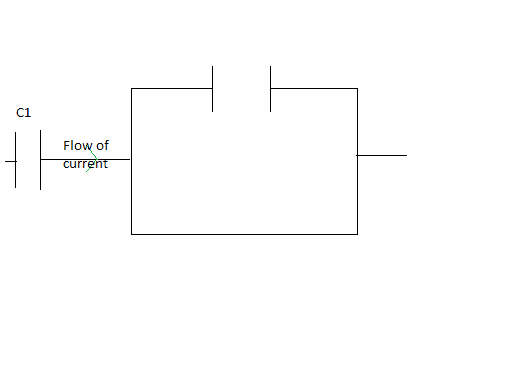

Does that mean in the following sketch, the equivalent capacitance is C1?
Yes. Any component that's shorted becomes irrelevant and can be removed/ignored.
