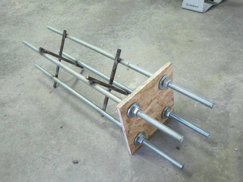

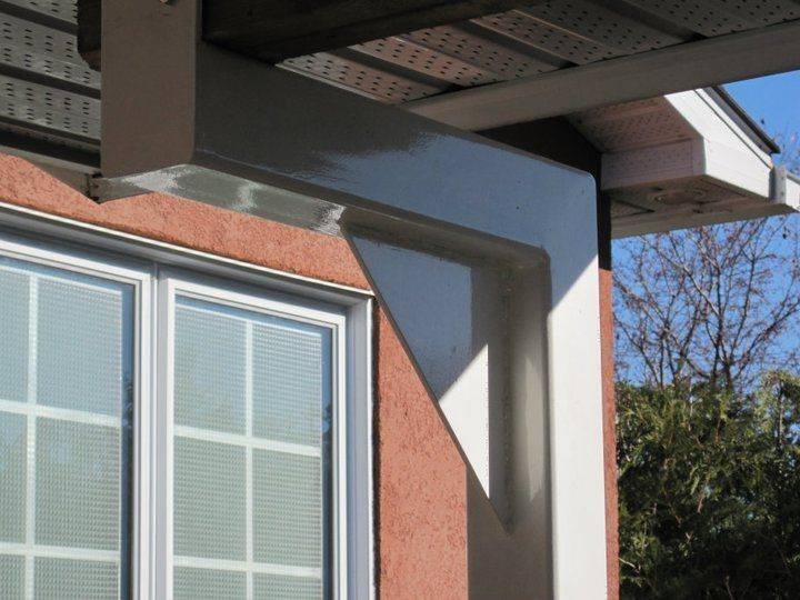

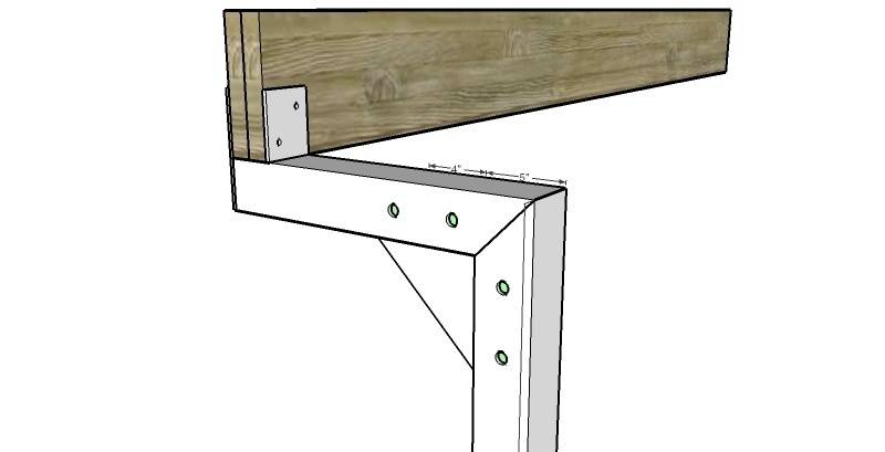

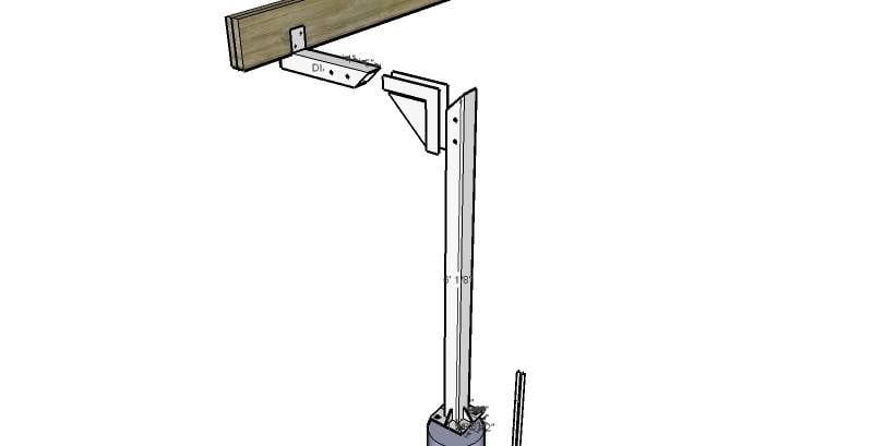

I have built a car port post in an inverted L shape and want to calculate the load that it can support.
I think I have “over-killed” the posts enough.
I am curious to see how much weight this structure could hold.
Any way of calculating the load at the area which support the wood beam ?
All metal is 1/4" thick.
Base mounting bolts/rod is 5/8"
All joints are welded with arc-welding @ 7018 @ 1/8" rod.

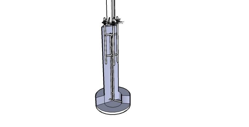

Concrete base 12" sonotube with 24" footing @ 8" thick.
Embedded re-bar 2 part setup .
See attached pictures.
Where do you live?
Where I live - in Canada, Sonotubes are not a good thing. Water seeps down, freezes in the winter and then pushes the concrete straight up the smooth inside of the Sonotube.
And we got to go down 36" - 48".

Thanks for the reply Dave, I live near Ottawa, Canada.
I have poured a 24" diameter footing @ 5ft deep then poured the sonotube on top of it with rebar joining the concrete footing and sonotube. Code require 4ft deep, I have 5ft, it should be good.
Sonotube without "base/footings" if not deep enough will be moved out of the soil from freeze and thaw. (i.e. most people do the sonotubes for fences and dig only 24", 2 years after the fence is out of alignment).
Cheers!
Ben
Ah! (Chance were highly unlikely you were anywhere near as far North as I - let alone farther. High five!)
Jesoosi Chistoosi - are those four inch square steel tubes? You could park a second car up there!
Almost ... 3.5" tubing @ 1/4" in thick.
I know, it's overkill haha, but I would really like to see how much it can support.
A car... or a dump truck ? haha.
