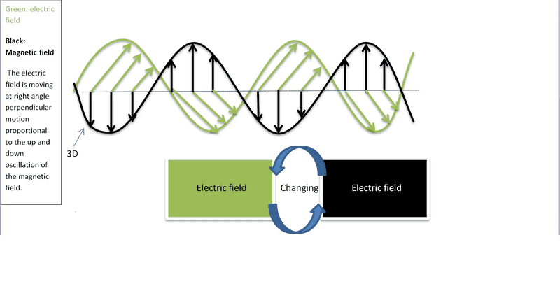

I changed it up a bit what do you guys think?
When we have an electric field somewhere in space, it is created by electrons accelerating in an antenna between two metal plates (oscillator), which send the electric field into space. This electric field can be used to create a magnetic field. For this to occur all that is needed is a change in that electric field that is sent into space by sending a magnetic field as well causing them to change each other causing one their electrons to propagate up and down. These two changes can reoccur on regular intervals creating a loop of electric fields changing into magnetic fields; this was figured out by James Maxwell. When the loop occurs, it is created by oscillating waves from the magnetic or electric changing field, which are in a way independent from their origin (parent charge).
Or
When we have an electric field somewhere in space, it is created by electrons accelerating in an antenna between two metal plates (oscillator). The antenna then sends the electric field into space. This electric field can be used to create a magnetic field. For this to occur all that is needed is a change in that electric field that is sent into space, by sending a magnetic field as well causing them to change each other causing the magnetic and the electric field to be perpendicular to each other. These two changes can reoccur on regular intervals creating a loop of electric fields changing into magnetic fields; this was figured out by James Maxwell. When the loop occurs, it is created by oscillating waves from the magnetic or electric changing field, which are in a way independent from their origin (parent charge).
Okay I just realized there is some wrong statements in there so I've changed it once more
When we have an electric field somewhere in space, it is created by charges accelerating in an antenna between two metal plates (oscillator). The antenna then sends the electric field into space. This electric field can be used to create a magnetic field. For this to occur all that is needed is a change in that electric field that is sent into space, by sending a magnetic field as well, it will cause the two to connect. The magnetic field will move up and down in an oscillating motion and the electric field to move perpendicularly to the magnetic field (basically they are moving in a perpendicular motion to each other). These two changes can reoccur on regular intervals creating a loop of radiated electric fields creating radiated magnetic fields and vice versa; this was figured out by James Maxwell.

As far as I can see, an accelerating electric charge produces an electric transverse wave, and when this passes an observer we see an in-phase magnetic field.

I was also able to come up with a final answer tell me what you think.
When we have an electric field somewhere in space, it is created by charges accelerating in an antenna between two metal plates (oscillator). The antenna then sends the electric field into space. This electric field can be used to create a magnetic field. For this to occur all that is needed is a change in that electric field that is sent into space, by sending a magnetic field as well, it will cause the two to connect. The magnetic field will move up and down in an oscillating motion and the electric field moves perpendicularly to the magnetic field (basically in a right angled perpendicular motion). These two changes can reoccur on regular intervals creating a loop of changing electric fields creating changing magnetic fields and vice versa; this was figured out by James Maxwell. Radio waves are produced in this process. Cellphone communication is possible by transmitting these radio waves in the microwave frequency range with transmitting towers that have microwave mats, which are then sent to satellites in space in the form of signals (radio waves) allowing for communication through cellphones.I also created a diagram:

I feel this reply fulfils its purpose. Well done.
