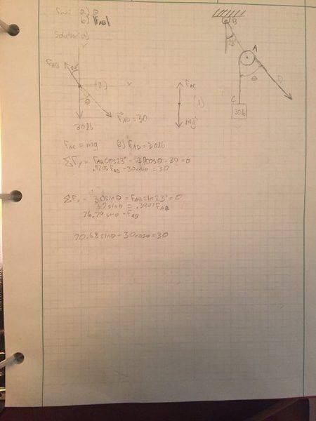

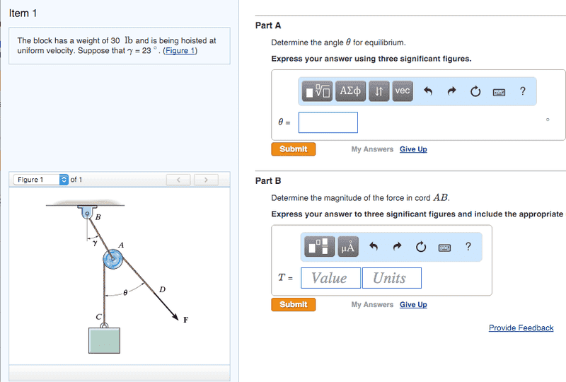

Given the picture, find theta, and the magnitude of the force going from point A to B.
I have asked multiple people how to solve this problem and they have no idea, I end up getting 2 equations with 2 unknowns but then when I try to solve for theta I get 70cos(theta) - 80sin(theta) = 30 or something like that and idk what to do with that.
I'm a tutor at my college so I get how someone might just want to half way give me the answer and let me solve the rest of it because most of the time you learn more that way, but with this problem, I think it would be best is someone could just walk me through it, I've already stared at it for hours with multiple people/teachers and we can't get it.
Thanks to anyone that attempts this! I really appreciate it!

Re idk: But you do know that ##\cos\alpha \cos \beta - \sin\alpha \sin\beta = \cos(\alpha+\beta)## so dividing left and right by ##\sqrt{70^2+80^2}## should help you solve your goniometric equation...

hmm, i'll try that and see if it works. I just realized that it's actually 70.6sin(theta) - 30cos(theta) = 30, so how would that trig identity change?

Not making much headway here, are we. How about following the suggestion to use symbols instead of numbers ? From the picture attached I decipher and re-write:
$$ \eqalign { F_{AB}\;\cos\gamma &= mg\;(1+\cos\theta) \\
F_{AB}\;\sin\gamma &= mg \; \sin\theta }$$ so what's more straightforward now than to eliminate ##F_{AB}## and ##mg## by dividing the second one by the first one to get the goniometric equation $$ \tan\gamma = {\sin\theta \over 1+\cos\theta}$$Then amongst all these learned persons there will be one who says: hey, why don't we express the righthand side in ##\theta\over 2## ? No need to use the brute force approach (that works for numbers) I described earlier.
You've got all weekend to work this out !

thanks man I appreciate you helping me out with all of this.
I found out that theta is actually twice the given angle of 23 though lol..so theta is 46.
Eureka ! And it fits with the extremes ##\theta = 0## or ##\theta = \pi/2## :smile:
Tensions in DA and CA are the same . Line of action of resultant of the two tensions bisects the angle theta .
Continuation of line of action of resultant must run along axis of link AB .
By inspection : gamma = half theta .
