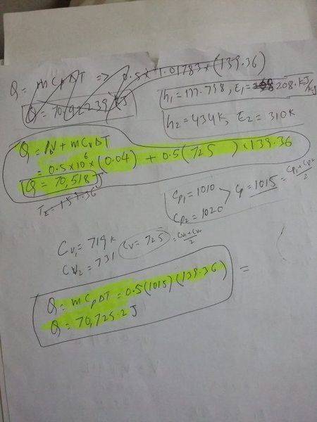

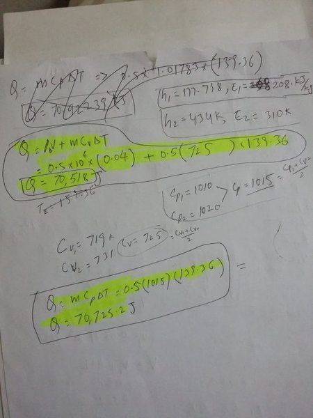

Can we find the "amount of heat required to raise the piston to certain height, with constant pressure, adiabatic process ( air is the substance, initial and final temperatures and volumes are given)" by using (1) concept of change in enthalpy or using the formula (2) Q=delta U + delta W = mCv*deltaT+P*deltaV or by the formula (3) Q=mCp*deltaT ?? which one is the correct way? I have noticed a little difference between
2nd and 3rd method
2nd and 3rd method
.View attachment 97293
You indicated in your problem specification that the it is an "adiabatic process." But this process certainly isn't adiabatic if heat is being supplied to the gas. In any event, for this process, the amount of heat is equal to the change in enthalpy, irrespective of whether the gas is an ideal gas. So method (1) will always be correct, if you have air tables with enthalpy values. Methods (2) and (3) assume you are dealing with an ideal gas for which both U and H are independent of pressure (assuming that, by Cp, you mean the value of the heat capacity in the limit of low pressures). Method 3 would be correct if the value of Cp used were evaluated at the operating pressure P, rather than at pressures approaching ideal gas behavior)

Yes you are right. Actually, heat is not supplied though the walls of cylinder, but it is the electric heater which is doing electric work. Well, thank you very much.
