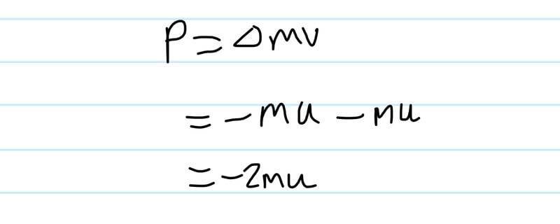

A gas with particles of mass m and number density n is in a closed cylinder with a piston of area A. The cylinders initial length is L0. Th probability distribution of velocities in the x direction is p(v).
At time t the piston moves with velocity -u in the x direction. The piston ives much slower than the mean speed of the particles. The volume of the cylinder is reduced according to V= A(L0-ut). Show that the additional momentum from the piston is -2mu and the change in energy of the particles is 2muv. Where v is the velocity of a particle after colliding with the piston. Hint: consider a collision in the piston reference frame.
I am familiar with kinetic theory and know how to derive P = 1/3nmv^2 from a similar set up, but I’m not sure how to work out the momentum in this one.
p = mv
The question has nothing to do with the actual kinetic theory. It is just a matter of ellastic collisions. You need to apply the usual treatment of an ellastic collision and take the limits indicated (m<<M and u<<v).
So if your just considering the additional momentum could you write
but then how can I use that to find the internal energy

Apply the results for elastic collision to find the final velocity of the particle and then you can use this velocity to calculate both momentum and kinetic energy in the initial and the final state and the change in both.
maxim07 said:
The advice made sense I just thought it only referred to the part of the question about momentum
Well, then, I suggest you take the advice. Have you reviewed the topic of elastic collisions in an introductory college-level textbook?
So applying energy conservation in an elastic collision I’d have 1/2mv2 + 1/2Mu2 = 1/2mvf2 + 1/2Mu2 if I consider the energy of the piston too. Where vf is the final velocity of the particle. But then I’d get vf= v so that must be wrong
You keep guessing rather than using the equations. The final velocity of the particle is not u (in magnitude). You need to use both momentum and KE conservation. Or just look up the formulas for final velocities.

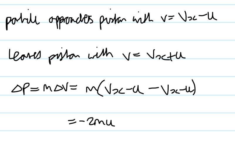

We agree. It’s just that my preferred approach is to use the hint given at the end of the question: “consider a collision in the piston reference frame”.
In the piston reference frame, the particle’s x-velocity is simply reversed. The initial and final particle velocities in the lab’ frame (in terms of u and v) follow from that.

Okay, but then for 2 b wouldn’t I get Δp = -8 - 2 = -10 Kgm/s, am i supposed to be getting Δp = 6 Kgm/s as this is -2mu = -2(1)(-3) as the question requires?
The 2mu is the additional momentum from the wall. This is what you say in the OP. With fixed wall the change in momentum is 4 units. With moving wall is 10. Or, in magnitude, initial momentum is 2 and final is 8. Either way, the effect of moving wall is 6 units extra.
okay I see, then to get the change in internal energy ΔE = 1/2m(v+2u)2 - v2) = 2muv if you consider u << v, where (v+2u) is the velocity of the particle after the collision

Yes, for kinetic energy the change is 2muv as first approximation.
