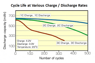

High charge rates for long periods cuts a little into battery life. Braking power last for seconds, and rarely gets above a dozen kw.
So the ~90kW Tesla's absorb from supercharging for about 40min does not cut into battery life?
Batteries come with so many charge cycles at a given rate of charge/discharge. Increasing the rate of charge reduces the number of cycles. Typical cycle life chart (not for the Model S):
This might be part of the reason Tesla has been exhorting its owners to use supercharging stations only for long distance and away from home travel, and not for everyday use.
...As a frequent user of local Superchargers, we ask that you decrease your local Supercharging and promptly move your Model S once charging is complete….”
