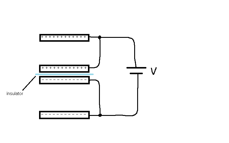

Here's the scenario:
I need two plates that start off in proximity (a few mm apart), and I would like to vary the charge in these plates to achieve a repulsion force. Ideally it would be varied by a voltage source, so that I have fine control over the repulsion.
But as it happens, it is not a simple matter of connecting the two plates to the same potential of a voltage supply. The scenario would work if I wanted to achieve attraction, by connecting one plate to positive and the other to ground. But in my case, no charging would occur.
So how could I charge two plates to the same charge and vary it at will, without fancy manoeuvres like taking it far away, charging by capacitance, disconnecting from voltage, and bringing it closer again?
Would something like this work at all?
What is the purpose of the outer pair of plates in that diagram?
In that setup the outer plates would actually be attracted towards the center and not repelled.
Firstly, the way the charge distribution is drawn on the diagram is wrong - the unbalanced charges would nearly all be on the inner two plates because the local field in the gap is higher than anywhere else.
Secondly, the argument that the 'like charges' would be 'attracted to' each other is analogous to saying that the can of beans on a shelf is 'attracted to' the shelf, rather than both of them being attracted to the centre of the Earth. Any gravitational attraction (or electrical attraction, in the original model) will be finite but negligible. The net electric force between the upper plates will be one of repulsion.
To get a high repulsive force between two plates, you need a big charge on them.
To get as much charge as possible on the plates you can position them near a ground plane. The attractive effect of the ground plane will not be significant (for small angles) but the ground plane will increase the Capacitance of the system and Q = CV.
Alterrnatively, you could put grounded plates on each side of your suspended plates and significantly increase the electric forces as you will get attraction plus repulsion.
