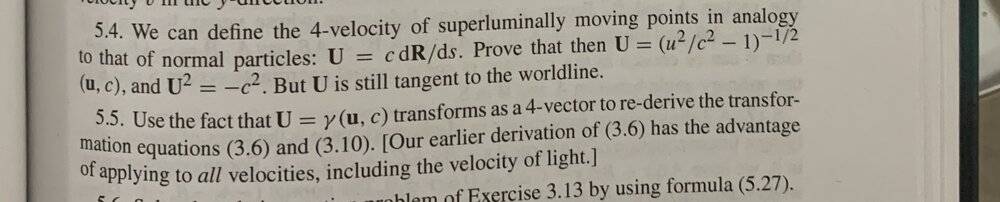

Also here's the question for completeness. 5.4.

The constraint that ##U^2 = - 1## made everything fall into place to the point where I think the problem statement may be flawed.
If we take a look at the problem statement it asks us to derive ##\tilde{U}## before proving that ##\tilde{U} \cdot \tilde{U} = - c^2##. With your approach (at least it seems to me) we imposed that ##\tilde{U} \cdot \tilde{U} = - c^2## on the way to deriving ##\tilde{U}## instead of the other way around. But I really do not see any other way to do it, therefore I think the problem statement may be flawed.
Here it is again,

If we take a look at the problem statement it asks us to derive ##\tilde{U}## before proving that ~##\tilde{U} \cdot \tilde{U} = - c^2##. With your approach (at least it seems to me) we imposed that ##\tilde{U} \cdot \tilde{U} = - c^2## on the way to deriving ##\tilde{U}## instead of the other way around.
Hm, yes, that's an interesting point. I'm not sure if the intent of the problem statement was to derive those things in exactly that order (textbooks vary on things like this). I'll have to think about it some more to see if I think there's a way to do it in exactly the order given in the problem.

The question is whether (a) you can prove ##\mathbf{U} = ( u^2 / c^2 - 1 )^{- 1/2} ( \mathbf{u}, c )## without using ##\mathbf{U}^2 = - c^2##, and (b) you can prove ##\mathbf{U}^2 = - c^2## from ##\mathbf{U} = ( u^2 / c^2 - 1 )^{- 1/2} ( \mathbf{u}, c )##, without using any of the above. I'm not sure that (a) is possible, but I want to think about it some more. It looks to me like (b) is straightforward, but without (a) it's not enough by itself if we insist on proving what the problem asks us to prove in the exact order given.

##\tilde{U} \cdot \tilde{U} = c^2##
Using signature (+,-,-,-)
##\tilde{R} = \left( ct, x, y, z \right)##
##\tilde{U} = c \frac{d \tilde{R}}{ds}##
##\frac{d \tilde{R}}{ds} = \left( \frac{dt}{ds} \right) \left( c , \dot{x} , \dot{y} , \dot{z} \right)##
So what is ##\frac{dt}{ds}## equal to?
consider
##\frac{d \tilde{R}}{ds} \cdot \frac{d \tilde{R}}{ds} = \left(\frac{dt}{ds}\right)^2 \left(c^2 - u^2\right)##
We know that ##u^2 \gt c^2## so the quantity directly above is negative. We also know that the derivative of a curve with respect to its own arc-length has to have magnitude of 1. Therefore,
##\frac{d \tilde{R}}{ds} \cdot \frac{d \tilde{R}}{ds} = \left(\frac{dt}{ds}\right)^2 \left(c^2 - u^2\right) = -1##
##\left( \frac{dt}{ds} \right)^2 = \frac{(-1)}{(-1)\left(u^2 - c^2 \right)} = \frac{1}{u^2 - c^2} \Rightarrow \frac{dt}{ds} = \frac{1}{\sqrt{u^2 - c^2}}##
##\tilde{U} = c \frac{d \tilde{R}}{ds} = c \left( \frac{dt}{ds} \right) \dot{\tilde{R}} = \frac{c}{\sqrt{u^2 - c^2}} \left( c , \dot{x}, \dot{y}, \dot{z} \right)##
So
##\tilde{U} = \frac{1}{\sqrt{\frac{u^2}{c^2} - 1}} \left( c , \tilde{u} \right)##
As for ##\tilde{U} \cdot \tilde{U}## we have
##\tilde{U} \cdot \tilde{U} = \frac{1}{\left(\frac{u^2}{c^2} -1\right)} \left(c^2 - u^2\right) = -c^2##
##\tilde{U} \cdot \tilde{U} = - c^2##I think proving that ##\tilde{U}## is tangent to the worldline is as simple as noting that ##\tilde{U}## is just a scalar (function) multiple of ##\dot{\tilde{R}}##.

  • #56
PhDeezNutz said:
I think your argument that ##\frac{d \tilde{R}}{ds} \cdot \frac{d \tilde{R}}{ds} = \pm 1## makes a lot of sense.
I actually was arguing that ##dR / ds = 1##, without the possibility of the minus sign. Your putting in the possibility of the minus sign brings me back to the question I asked in post #49, which nobody has responded to.
Focus on this step:
If you're saying that ##dR / ds = \pm 1## (i.e., either sign is possible), then you are saying that the RHS of the equation just above can have either sign. What does that mean?
It can't mean the individual components flip sign; their signs are fixed by the nature of the curve, i.e., the sign of ##d(c dt) / dt = c## is fixed at positive, and the signs of ##\dot{x}##, ##\dot{y}##, and ##\dot{z}## are fixed by the curve. So the only way to have ##dR / ds## be negative in the above is to have ##dt / ds## be negative.
Is this just another sign convention choice we can make? Not quite. What is ##dt / ds##? It's the rate of change of the ##t## coordinate, with respect to the curve parameter. For timelike curves, the usual conventions make this always positive: ##t## increases towards the future, and the curve parameter ##s##, which in this case is just proper time ##\tau##, also increases towards the future, so ##dt / ds = dt / d\tau## is always positive.
But for a spacelike curve, this is not always true. It's perfectly possible to have a spacelike curve whose curve parameter ##s## increases with decreasing ##t##. In fact, it's even possible to have a spacelike curve whose curve parameter ##s## goes from ##- \infty## to ##\infty## without ##t## changing at all! (Can you see how?) For this case, we would have ##dt / ds = 0## and the entire derivation breaks down.
Furthermore, even if ##dt / ds## is positive for a spacelike curve in one frame, it won't be in all frames if we hold the parameterization constant. We can always find a frame in which ##dt / ds## is negative (and indeed we can always find a frame in which it is zero).
In other words, the sign of ##dt / ds##, and therefore the sign of ##dR / ds##, is not an invariant; it changes from frame to frame. As far as I can tell, this fact is ignored in the problem statement, which, as far as I can tell, expects you to assume that ##dt / ds## and hence ##dR / ds## is positive, just as you would for a timelike curve. But in general, as we've shown above, the sign of ##dt / ds## and hence of ##dR / ds## depends on the choice of frame and the direction of parameterization of the curve (i.e., in which direction along the curve ##s## increases). In order for the derivation to hold in any frame, we have to assume we are changing the parameterization of the curve as we change frames, in order to keep ##dt / ds## and hence ##dR / ds## positive. (And even that won't help in a frame where ##dt / ds = 0##.)

I am unable to figure out how to break up your post and respond to individual parts.
I believe if I am saying ##\frac{d\tilde{R}}{ds} = \pm 1## in the equation ## \frac{d\tilde{R}}{ds} = \left( \frac{dt}{ds} \right) \left(c , \dot{x} , \dot{y}, \dot{z} \right)## that ##\frac{d\tilde{R}}{ds}## is either parallel or anti-parallel to the trajectory. It should be parallel to the trajectory so we have to restrict ourselves ##\frac{d\tilde{R}}{ds}## = 1.
As for a space-like curve whose curve parameter ##s## goes from ##-\infty## to ##+\infty## without ##t## changing at all I don't know. It would correspond to a horizontal line in a Minkowski diagram but I don't know how to interpret that. I know how to interpret a vertical line in a Minkowski diagram; just a particle that stays in the same place for all time.
So I take it there are a lot of implicit assumptions in the problem statement. I never thought about that; ##\frac{dt}{ds}## changes depending on which frame we are in and can be either positive or negative. I think if the particle is moving towards us ##\frac{dt}{ds}## is negative and away from us ##\frac{dt}{ds}## is positive.
That said I think I found a way around using ##\frac{dt}{ds}##. We've already established that
1) In order for ##U^2 = - c^2## for a space-like curve we must use signature ##(+,-,-,-)##
2) ##\frac{d\tilde{R}}{ds}## must be a unit vector parallel to ##\dot{\tilde{R}}##
A key formula is equation ##(5.13)## from Rindler's book; the magnitude of a 4-vector is ##A = \left|A^2 \right|^{\frac{1}{2}} \geq 0##. And as @robphy pointed out.
##\tilde{U} = c \frac{d \tilde{R}}{ds} ##
##\frac{d \tilde{R}}{ds}## is a unit vector. A unit vector is a unit vector regardless of which parameter we use for the curve so we might as well use ##t##.
##\frac{d\tilde{R}}{ds} = \frac{1}{\left|\dot{\tilde{R}} \right|} \dot{\tilde{R}} = \frac{1}{\left| \dot{\tilde{R}} \right|} \left( c , \dot{x}, \dot{y} , \dot{z} \right)##
##\left| \dot{\tilde{R}} \right| = \left| \dot{\tilde{R}} \cdot \dot{\tilde{R}} \right| = \left| c^2 - u^2 \right|^{\frac{1}{2}} = \sqrt{u^2 - c^2}##
##u \gt c##
##\frac{d\tilde{R}}{ds} = \frac{1}{\sqrt{u^2 - c^2}} \left( c , \dot{x} , \dot{y} , \dot{z} \right)##
##\tilde{U} = c \frac{d\tilde{R}}{ds} = \frac{c}{\sqrt{u^2 - c^2}} \left( c , \tilde{u} \right) = \frac{1}{\sqrt{\frac{u^2}{c^2} - 1}} \left( c , \tilde{u} \right)##
##\tilde{U} \cdot \tilde{U} = \frac{c^2}{\frac{u^2}{c^2} - 1} = - c^2##

  • #60
PeterDonis said:
What does "parallel" mean? I think if you try to answer that, you will find that it is not obvious for a spacelike vector that dR/ds=1dR/ds=1dR / ds = 1 must always be true.
That's a tough question. I would think that parallel means "same sign". Hard to know because this Minkowski space just seems so different from Euclidean space.
PeterDonis said:
Consider this curve: t(s)=0t(s)=0t(s) = 0, x(s)=sx(s)=sx(s) = s, y(s)=0y(s)=0y(s) = 0, z(s)=0z(s)=0z(s) = 0.
A point that is stationary, and time is always 0. Would that be the origin of a particle's rest frame?
PeterDonis said:
Think harder. See above. Or just ask yourself: what is the xxx axis in a Minkowski diagram?
the x-axis is literally the position correct? So time stays the same while position changes. I don't know how to interpret that. Again maybe the origin of a rest frame of a particle?
PeterDonis said:
No. See above.
I'm not trying to be obtuse. I don't see any other way how ##\frac{dt}{ds}## can change with frames without considering relative motion. Thanks for being patient with me, this subject is very new to me.
PeterDonis said:
No, you can't, because ttt is not arc length along the curve. (Also this would break down anyway in the case of a curve for which ttt is constant; I gave an example of one above.)
PeterDonis said:
This is not a valid statement. dR/dsdR/dsdR / ds is the derivative with respect to the curve parameter so its magnitude cannot possibly be independent of your choice of curve parameter.
Would the following be valid?
##\left|\frac{d\tilde{R}}{ds} \cdot \frac{d\tilde{R}}{ds}\right|= 1##
According to Rindler for a general 4-vector ##\left| \tilde{A} \right| = \left| \tilde{A} \cdot \tilde{A} \right|^{\frac{1}{2}} = \left| A^2 \right| ^ {\frac{1}{2}} \gt 0##. Hopefully that definition is not limited to time like vectors.
We know ##\frac{d\tilde{R}}{ds} = \left(\frac{dt}{ds}\right) \dot{\tilde{R}}##
So using the first equation
##\left|\left(\frac{dt}{ds}\right)^2 \left( c^2 - u^2 \right) \right|= 1##
We know ##u \gt c##
##\left|-\left(\frac{dt}{ds}\right)^2 \left(u^2 - c^2\right) \right| = 1##
##\left(\frac{dt}{ds}\right)^2 \left( u^2 - c^2 \right) = 1##
##\frac{dt}{ds} = \frac{1}{\sqrt{u^2 - c^2}}##
##\tilde{U} = c \left(\frac{dt}{ds} \right) \left( c , \dot{x} , \dot{y} , \dot{z} \right)##
##\tilde{U} = \frac{c}{\sqrt{u^2 - c^2}} \left( c , \tilde{u} \right) = \frac{1}{\sqrt{\frac{u^2}{c^2} - 1}} \left( c, \tilde{u} \right)##
