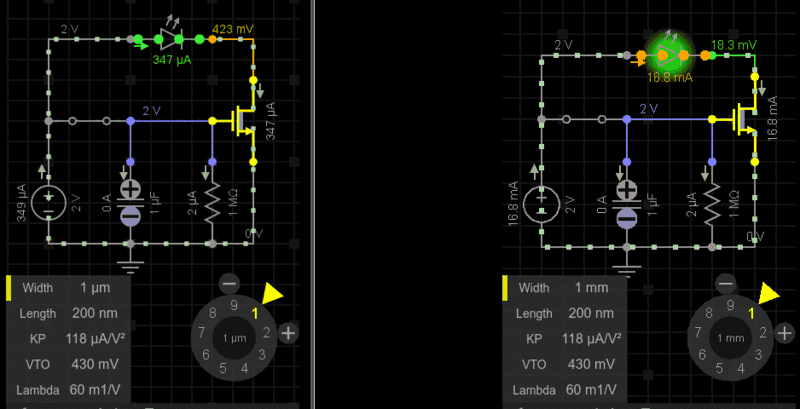

Hi.
Found a circuit pre made at everycircuit and tryed to reproduce it for scratch but the new circuit does not work. I am as new to electronics as one can be, so that is why i ask if i don't understand something with these circuits or is this probably a bug with everycircuit?
In image left is reproduced; Right original.
Credit for original circuit: bixio @ everycircuit
PS. This was the closest forum section i should find, Did not intend to wrong post is so.
  • Two side-by-side everycircuit screenshots of a MOSFET circuit with a 2 V source, 1 µF capacitor, 1 MΩ resistor and an LED; left shows 347 µA and 423 mV, right shows 18.8 mA and 18.3 mV, with the transistor width set to 1 µm on the left and 1 mm on the right.
What is this thing in the right lower corner, that is 1 μm on the left and 1 mm on the right?
Did not se that. Changed the reproduction to 1mm and it works. Thanks.
It is the width of an n-channel mosfet, That is all i know.
I should probably start taking a brake when I am stuck.
