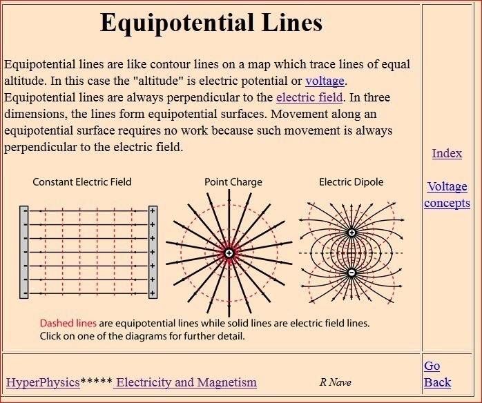

I think of wire as an equipotential surface
which it almost is,
so there's maybe a field perpendicular to the wire
with its E line originating on a free charge in the wire
and terminating on a free charge in a different wire on other side of the circuit
separated by circuit elements like resistors or capacitors or motors...
http://hyperphysics.phy-astr.gsu.edu/hbase/electric/equipot.html
Diagram titled Equipotential Lines showing three panels: constant electric field between two charged plates with parallel dashed equipotential lines, point charge with radial field lines and circular dashed equipotential lines, and electric dipole with curved field lines and dashed equipotential lines.
i have no idea if any of this is a useful direction of thought for you to pursue...
