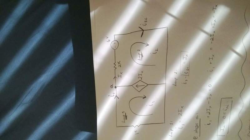

I am trying to solve for isc. The correct answer is isc = 6mA but I got 0 mA.
My equations must be correct... If they are not please someone explain why.
Thank you.

That's a rather difficult image to read: sideways and illuminated through a partially open blind.
Your choices for i1 & i2 are not the most convenient.
It looks to me like:
Ix = i2 = isc
and
2Ix = i2 - i1 .
