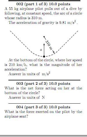

Can someone help me with part 3 of the problem?
For the acceleration I got 10.97670251m/s^2
and for the Net force I got 603.7186381 N
I did
fn-fg=fnet
and got
fn=1142.718638 and it was wrong

Interesting! I am still at a loss as to how to find the force exerted by the pilot :(
At the bottom of the loop the pilot is traveling at 210km/hr = 58.5m/s
Therefore the acceleration at the bottom of the loop = v^2/r = 11m/s^2
From this I got the force on the pilot to be 615N

Assuming your acceleration figure of 11 is correct [I have no reason to doubt, but I have not calculated it myself] then the force you have calculated is the net force on the pilot [or close to it].
That force is achieved as the sum of two actual forces - gravity and the force from the seat.
Gravity pulls down with a force approaching 550N [if g=10 it is exactly 550 N]
The seat has to push strongly enough that the net force is your 615N up.
Draw some vectors to see what you get [if necessary]
EDIT: I just calculated it without rounding off on the way through and got 1143.3 N

You are on the ball... I have made a slip in my calculations of x10
The acceleration at the bottom of the loop is 11m/s^2 which means that...
F-550N = 55 x 11 as the resultant force towards the centre of the circle
This gives F = (55 x 11 ) +550 = 610 + 550 = 1160N as the force on the pilot
... I have just seen your answer of 1143... will double check that I have not made 2 c ups
probably rounding off errors.

Yep! 55 x 11 = 605
and it should have been slightly less than 11 anyway.
Weight is 550N with g = 10, but you were told g = 9.81.
try 1143.268637993
