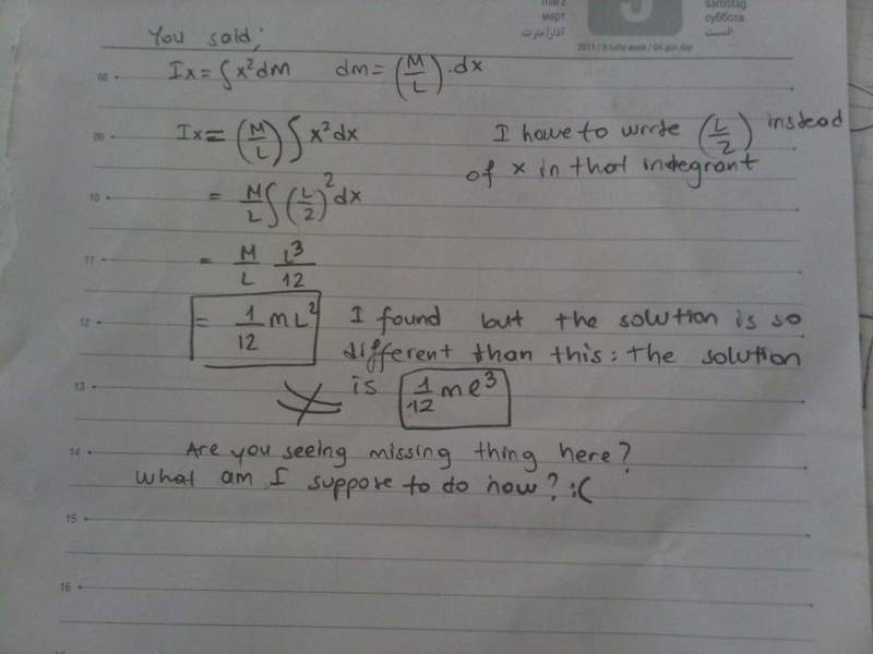

i have a problem again about that solution, Could you check this out again?
Giving your solution in an attachment makes it more difficult to comment on each step.
Why do you think you need to substitute L/2 for x in the integrand? First do the integration, then substitute the range of variables.
because I have to calculate moment of inertia according to the central axis. that's why I have taken that L/2.
I have been trying to clarify that problem since morning but I still can not. If you say to me how to solve that. Iwill finish that things. please. by the way.. I have tried to solve without putting L/2 first. I found Ix= ML^2 / 24.
Maybe it is so simple to see that here for you, but I cannot. If I bored you sorry! I am just going to second class of my undergraduate.
What you're trying to do is evaluate the definite integral:
(M/L)\int_{-L/2}^{+L/2} x^2 dx
First find the antiderivative of x^2, then evaluate using the limits of integration.
that has been so clear for me, Thank you for helping me :) my problem was to understand the boundries.. okey..
