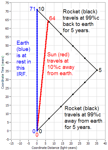

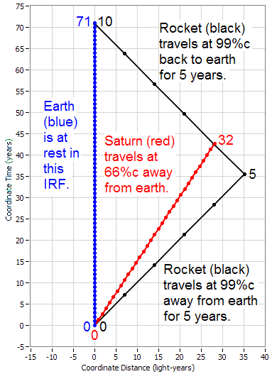

Let me show you some spacetime diagrams to illustrate the concepts that you have been raising in this thread. We'll start with the rest frame of the Earth and with the sun traveling at 10%c. The rocket travels at 99%c for 5 years, then turns around for another 5 years to get back to earth. The dots mark off one-year increments of time for each object:
As you can see, the Earth has aged 71 years compared to 10 years on the rocket when they meet. But the sun has aged 64 years by the time it meets up with the rocket which is not the huge difference you expected. Note that the Time Dilation of the rocket is the same during both halves of its trip according to the IRF in which the Earth is at rest.

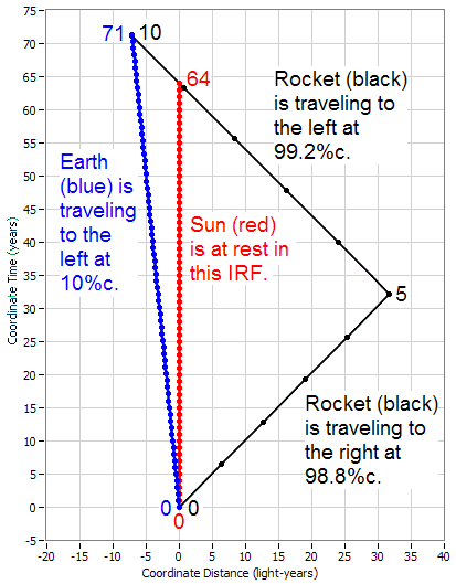

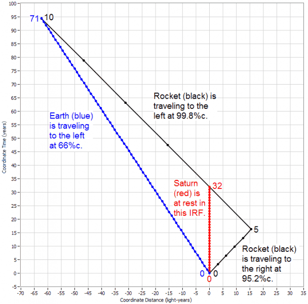

Now we can use the Lorentz Transformation process to see what this scenario looks like in the rest frame of the sun:
Although the Lorentz Transformation automatically determines all the details of all the objects, it might be a little hard to see the actual speeds of the rocket during both parts of its trip. We can use the velocity addition formula for this purpose. For velocities that are fractions of the speed of light where c=1, it looks like this:
s = (v+u)/(1+vu)
For the situation where the rocket is traveling in the same direction as the sun, we have to set v = 0.99 and u = -0.1:
s = (v+u)/(1+vu) = (0.99-0.1)/(1+(0.99)(-0.1)) = (0.89)/(1-0.099) = (0.89)/(0.901) = 0.98779
And for the return part of the trip, we set v = 0.99 and u = 0.1:
