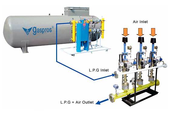

Welcome to the PF.
Sorry, but your post is not very clear. Can you post links to the types of LPG cylinder systems you are referring to? Something like this?
http://www.venusgas.com/images/airmix.jpg
Is the idea to increase the pressure in the tank with CO2?

The kind of cylinders I talk about is this: http://www.ppsolutions.com.tw/plasticnotes/lpg-cylinders-technical-specification
Manufacturer deliever the cylinder with atmosfære of CO2 insteed of air. This make the lpg Easy to ignite the forst time after filled with lpg.
If air inside the air comes out first and can't be ignited. CO2 mix with log and ignite easy.
Will Nitrogen mix with log? Or will IT come out of cylinder first, like air?
