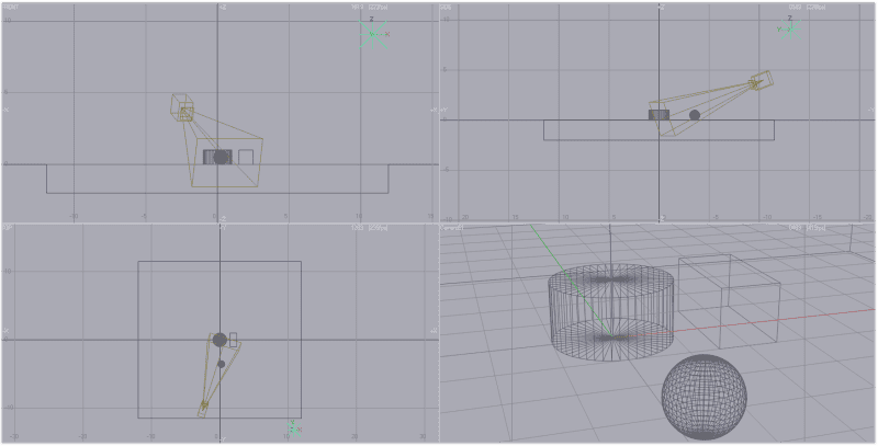

With one type of Computer graphics modeling called Ray-tracing, the computer creates a virtual 3D space. Here is a screen capture from a modeler called Moray.
It shows four views of the space, front, top, side and camera. In the space, are the objects (in this case a cylinder, sphere, and 2 boxes), the position and aim of the camera, and a light source. The camera view is created from this info , as a wire frame image.

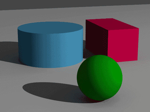

To create an graphics image from this, the ray-tracing program calculates the path of rays leaving the light source, striking a surface and bouncing to the camera. he properties of the surface where a ray strikes an object determines what color the camera "sees" from that point in its field of view and determines what color the pixel at that part of the image will be.
Here's a simple image created from the above model.
Note that it gives simple shading and shadows for the objects, all by calculating the paths of imaginary light rays. Here the object surfaces were also given color.

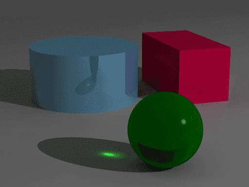

You can add more complexity by adding surface roughness, highlights, reflection, transparency and refraction and other effects.
Here is the same scene with some of these additional effects added.
Again this is done by calculating the paths of rays from light to camera and how it would interact with objects in the scene along the way and working out the color of the pixel depending on the assigned properties of the objects in the scene.

Consider 3D space, where each point is defined as having coordinates (x,y,z). To display this on a 2D surface, use the perspective transformation which maps (x,y,z) in 3D space onto a point (x',y') in 2D space. You can look up perspective transformation. It's simple mathematically. Think of looking at a real world scene outside your window, and trying to draw that scene on your window, with your eye at a fixed point. Or think of a camera, where the 3D reality is projected onto the 2D film surface.
Once you have coordinates in 2D space, then it's just a question of mapping the 2D coordinates to a point on the screen, which is also 2D. In other words, you map (x',y') to a pixel (x'',y''). You can look this up also.
The units are up to you. A distance of one unit in my 3D world space might represent any number of cm I want. What I select depends on the application.
As far as simulations or animation in general, one is moving the scene, or the camera, or both. The computational challenge in real-time 3D animation is that one must normally recalculate the transformation of 3D object onto the computer screen many times per second in order to achieve a realistic looking animation.
If I draw something from an angle, say a cuboid which stretches from x'y to xy, it will be a flat image. A picture taken from a camera or a sketch of what I see from the window is also flat. Once done, I cannot manipulate the data, no further changes can be made. Co-ordinates in computers are like me telling you where to plot the points on a numbered graph and instructing how to connect those points, I know this much. But what I do not understand or need a confirmation on (I had a thought which is mentioned in my previous post) is how the spacing between the points is defined and how the the image of the model is instantly rendered on screen if I rotate it or change the camera angle.

Taking the second part of your question first, the image of the model appears to be rendered instantly (hopefully at least) because the calculations are done very quickly. Behind the scenes, the program is recalculating the new projection of the 3D coordinates of the object onto the 2D pixel coordinates. Then the new 2D pixel coordinates are used to draw the next frame. So if, for example, we have a stationary camera, and the object is a cube, and the cube is rotating, then the 3D coordinates of the cube's vertices are changing, and those new vertices need to be transformed into pixel coordinates. What happens during the actual drawing is that we have triangles (think of two triangles per cube face) which are drawn and filled in with the appropriate color or texture. Each triangle is defined by three vertices. We use triangles because the GPU is good at drawing triangles very quickly. For more details, I really suggest finding a good book on 3D real time graphics. You may also be interested in a book on Physics for Game Programmers. Not that you are necessarily a game programmer, I just mention that because that is a good place to find this information. As for spacing between points, if you mean mapping real-world spacing into a 3D coordinate system to begin with, that's somewhat arbitrary. I could represent a real-world object using many different coordinates, depending on my choice.
