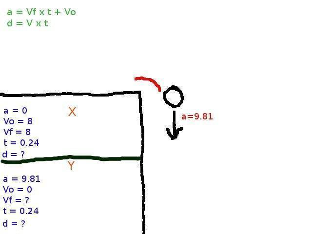

  • #55
Gimme some minutes, I will draw something.
  • #56
I won't be leaving anytime soon, so take all the time you need. lol thanks.
  • #57
There.
  • #58
See the big black line between X and Y ? That's on purpose. They are to be resolved SEPARATELY.
  • #59
k, i ll try out the problem, give me a sec or 2
  • #60
oops there's a error. it's "a = Vf X t² + Vo"
Sorry.
I was trying to make a good drawing lol
  • #61
damn it misses a 0.5 too.
  • #62
Anyway you have the formula. I drawed it very quickly

  • #65
I mixed up, it's my fault. I will correct my drawing gimme some minutes.
  • #66
no worries.
  • #67
ok, so I found Veloc of y =2.35m/s and Veloc of x =8m/s
  • #68
I have 9.79m tall for the height
  • #69
I corrected
(sorry I'm a little drunk, had problem with my integrals lol)

AAh you really want me to get my pencils out to resolve that eh ? :P
  • #81
Ok! So after reworking the problem with different numbers this is what i did and the problem i needed to resolve:
A ball rolls off a shelf which is 2.8 meters high. If it leaves the shelf with a horizontal velocity of 6 m/s, calculate the distance from the base of the shelf at which the ball will strike the ground.
first i used Dvert=1/2at^2 so, 2.8=1/2 x 9.81 x t^2 solving for the time- the time it would take the ball to hit the floor. after square rooting it took aprox .75s to fall.
using Dhoriz=Vot D=6 x .75 the distance from the base at which the ball will strike the ground is 4.53m!
-There is only one other problem I am unable to resolve...
taking a trip you travel 63mph for 30 min, 22mph for 45 min and stop to eat for 20 min. What is your average speed for the entire trip?
what i keep doing is adding the speeds and averaging them, 63+22+0/3=28.33, this answer is wrong(the computer program for school i am using keeps telling me this) Total time is 95 min=1.55hours, i have tried several different ways and just do not get this problem(it seems easy though!)edit+ 85/1.55 =54.83
If you or someone could show me how to approach these types of problems dealing with different speeds over time that would be great. Thanks again proc!
