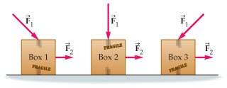

The three identical boxes shown in the figure remain at rest on a rough, horizontal surface, even though they are acted on by two different forces, F1 and F2. All of the forces labeled F1 have the same magnitude; all of the forces labeled F2are identical to one another.
Rank the boxes in order of decreasing magnitude of the force static friction between them and the surface.
Rank the boxes from highest to lowest magnitude of the force static friction between them and the surface. To rank items as equivalent, overlap them.
I thought it would be box 1, 3, then2 two but that it not right.

Why makes you think that?
Well the F_1 on box one is pushing in the same direction as F_2 so, it had the most net force on it.. I thought. and the box two only has F_1 pushing down on it and F_2 pushing to the right.
Your answer is partially correct. Think in terms of horizontal components of the vector sum of F1 and F2 on each box. Which box has the largest total horizontal component on it? That's the box that needs the largest static friction to cancel it. Which box has the next largest horizontal component and which one has the least?
thank you that helped! :))
