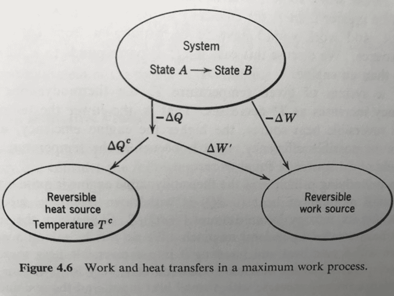

Callen does not assume that any heat lost by the primary subsystem must be exchanged with the RHS. Callen allows for the possibility that some of the heat lost by the primary subsystem could be converted to work ##\Delta W'## (using a heat engine for example). This work would be delivered to the RWS and the remaining heat ##\Delta Q^c## (the exhaust of the engine) would then be delivered to the RHS. See the second answer posted in your link. The total work delivered to the RWS would be the work done by the primary subsystem plus the work ##\Delta W'## that came from converting some of the heat lost by the subsystem to work. Only part of the heat ##-\Delta Q## lost by the primary subsystem is delivered to the RHS.
In the first edition of Callen's text, he included the following diagram that I don't see in the second edition.

I think I see, thanks so much for your answer. In short, would it be fair to characterize your answer as agreeing with the second answer in my link -- namely that Callen tacitly allows for some auxiliary system to "transmit" heat to work as long as its state is not changed by the end of the given process?

Yes.

That’s a good point to emphasize. The auxiliary system needs to return to its initial state in the overall process.

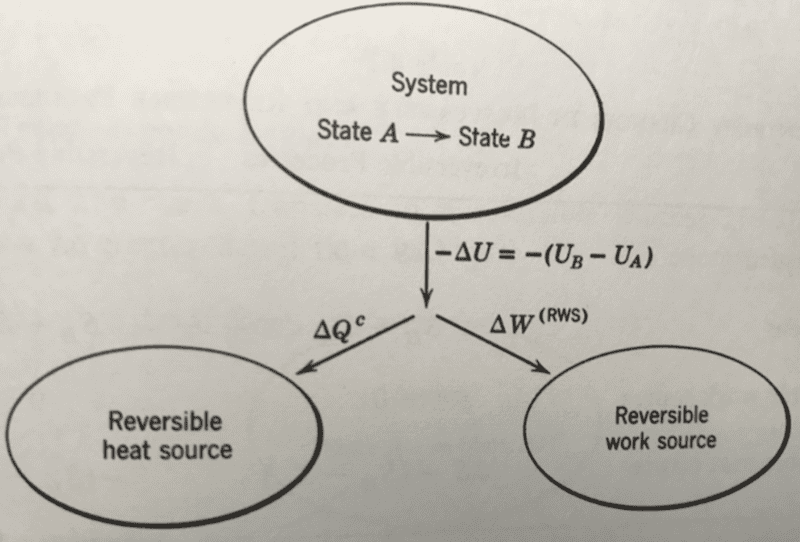

I believe Callen does allude to “auxiliary systems” or “engines” in the introductory section 4.1. Here, he considers the example of an engineer who wishes to use some of the internal energy in a furnace to lift an elevator. The “engine” in this case corresponds to “the various pistons, levers, and cams” used to somehow link the furnace to the elevator. I think that Callen is pointing out that the first and second laws of thermodynamics (energy is conserved, total entropy can’t decrease) limit the amount of work that can be delivered to the elevator. It doesn’t matter how clever the engineer is in designing an engine or auxiliary system to perform the task. The laws of thermodynamics can be used to find the maximum work that can be delivered to the elevator for a given amount of energy taken from the furnace.

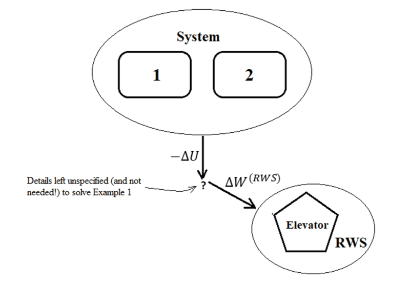

We can relate this example to the schematic diagram used later in the chapter:
We take systems “1” and “2” together as the “System”. We can let the elevator represent the reversible work source.
In Example 1 we do not need to make use of a reversible heat source, so it is not shown.
The choice of the auxiliary system (shown by the “?” in the diagram), which converts the energy extracted from the System to the work delivered to the elevator, is not required to be known in order to solve the problem in Example 1.

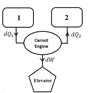

After studying heat engines in the later sections of the chapter, you can see that the auxiliary system could be a Carnot engine using the hotter system “1” as the heat source and the cooler system “2” as the heat sink for the engine.
Each cycle of the engine takes a little heat ##dQ_1## from "1”, delivers a little heat ##dQ_2## to “2”, and delivers some work ##dW## to the elevator. The temperature of “1” drops while the temperature of “2” increases until “1” and “2” reach the same final temperature ##T_f##. A calculation using the efficiency of a Carnot engine and the heat capacity ##C## of systems “1” and “2” leads to a total work delivered to the elevator that matches the result obtained in Example 1.
