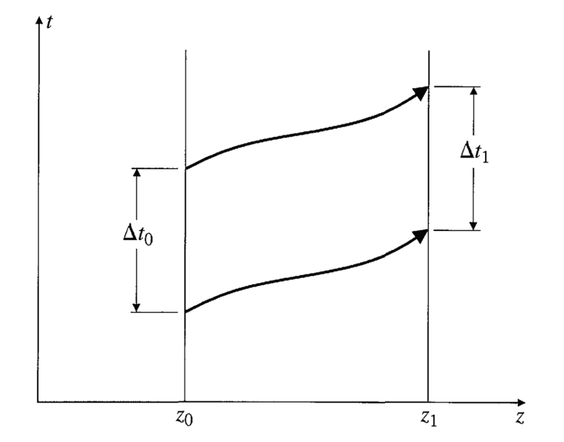

I'm reading Carroll's GR book and can't quite understand one particular statement. I'll summarize for context:
There's a tower with a physicist at the base and one at the top. Ground guy emits a beam of light with wavelength ##\lambda_0## from height ##z_0##, which travels to the top of the tower at height ##z_1##. The time between the beginning and end of the emission of any wavelength of light is ##\Delta t_0=\lambda_0/c## (measured w.r.t. a clock at the base). The time interval for the absorption of that wavelength is ##\Delta t_1=\lambda_1/c## (measured w.r.t. a clock at the top). Since we imagine that the gravitational field is static, the paths through spacetime followed by the leading and trailing edge of the single wave must be precisely congruent.
The spacetime diagram is like this:
I did not understand the line in bold. Could anyone please explain what's the reasoning behind that statement?

Same spatial path traveled at the same speed profile in the same space-time geometry, just at a different time, means the world-line has the same shape, and is just shifted along the time dimension.

What was meant is that spacetime looks the same everywhere (i.e. the ##t## and ##z## axes are straight and the coordinate lines are all straight). An uneven gravitational field but with Euclidean spacetime would still give congruent worldlines, but even a uniform gravitational field but in curved spacetime would give non-congruent worldlines.
No. You can always draw straight axes on a map of the nastiest twistiest spacetime you can imagine (as long as you avoid coordinate singularities and the like). The axes won't necessarily be straight in the real world!
The point about these axes is that if you follow the timelike axis or any line parallel to it, you will always "see" the same gravitational foeld around you. So if you hover above an idealised spherical Earth you will find any gravitational experiment you do (throwing a ball, for example) always has the same outcome. Contrast with the real world, where you will feel a varying pull from the Sun and moon and planets, and even density variation in the Earth. The former is a static field, the latter is not.
So the point Carroll is making is that the light paths must be the same because nothing has changed during the experiment. So whatever path the light follows (whether it interacts with gravity or not) must be the same.
You can then, as Peter says, make an argument that we believe that the light path must curve locally because we believe the equivalence principle.
I understood the rest of your post. The above quote is the key though. I think "whether it interacts with gravity or not" is the key distinction. From the naive PoV of someone who doesn't know that a changing gravitational field curves spacetime, if light didn't interact with gravity, then even a changing gravitational field wouldn't affect the light. Peter's answer clarified for me that curved spacetime isn't really a pre-requisite for saying that light interacts with gravity (the equivalence principle is) - which was my misconception.
So the way I now understand Carroll's argument is (again please correct me if I'm wrong) - light interacts with gravity. In the thought experiment we imagine that the gravitational field isn't changing with time (static). So the light wave's leading and trailing edge should behave exactly the same and follow the same path through spacetime => worldlines congruent. But we don't actually observe congruent worldlines => suggesting that the spacetime manifold may not be flat like a typical spacetime diagram suggests, but curved (accordingly the spacetime diagram will have some curved coordinate lines)
No. That's the point. Those worldlines are congruent - they must be because nothing changed in the experiment. Gravity didn't change, neither physicist moved, nothing got in the way. If you do the same thing twice under the same circumstances the results must be the same, so the paths must be the same.
But the equivalence principle tells me that the guy at the top must wait longer between the pulses than the guy at the bottom in a locally-SR universe, so I have discovered gravitational time dilation.

Actually, the worldlines that aren't congruent are the timelike worldline segments of the lower and upper observers between the two light pulses; as @Ibix notes, the upper observer's worldline segment is longer. That is the part that, at least according to the argument, indicates that spacetime must be curved in the presence of gravitational time dilation (because if spacetime were flat the upper and lower observers' worldline segments would be the same length).
However:
And what you've also discovered is that the argument as I've just stated it above can't be right, because you've just described a situation in flat spacetime that has the same property--gravitational time dilation--that the argument is using to deduce that spacetime is curved!
The previous thread I linked to earlier was one that I started based on that exact observation. The thread is a long one, but I think the upshot was that you need to add more assumptions to the argument to make it a valid one; just gravitational time dilation by itself isn't enough.

There is no such thing as "Euclidean spacetime". If you mean flat spacetime, by definition there is no spacetime curvature in flat spacetime so the issues under discussion cannot even arise.
There is no such thing as "a uniform gravitational field in curved spacetime".
