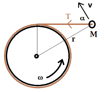

Thanks for the response—it seems reasonable enough, but I still have some confusion for an example such as this:
A mass is attached to a piece of string and the string is wound around a rod. The string is latched on to the rod and the rod is rotating at a constant angular velocity. The string is then unlatched, allowing the mass to move outward, increasing the moment of inertia, decreasing the angular velocity, and decreasing the rotational energy.
How could work be done on the string or mass in this example?
Right. I'll need to start doing some sums ! But for now, maybe:
M can be a mass on the end of the rope, or just the CoM of the extended rope maybe.
Now due to the tangential tension, there is a component of force accelerating it in the v direction, as well as the radial centripetal force. This force accelerates the mass as it moves outward, so that v increases to keep up with the constant ω as r increases. (v = rω)
So whatever is turning the drum is doing work on the mass to increase its KE.
Edit: Whoops ! I forgot ω isn't constant. So I definitely need to look at the sums first.
It's getting complicated with I increasing, ω decreasing, r increasing. I don't think v can stay constant, but there's the opportunity for work to be done either way through the rope tension. But once the drum is being forced to rotate, you are changing the rotational momentum as well as KE. Maybe if the drum is light and free to rotate how it will, when the rope is freed, the mass flies off at a tangent with constant KE and decreasing angular velocity to compensate for the increasing moment of inertia about the axis.

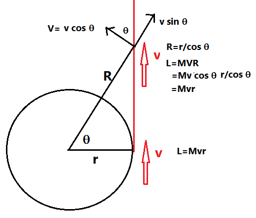

Ok.. ## \frac 1 2 mr^2ω^2 \ \ \ or\ equally \ \frac 1 2 mv^2 ## ie. it has so much KE whether we call it linear or rotational.
And ## angular momentum \ = Iω \ \ = mr^2ω \ =\ mvr ##
So now it flies off on its tangent with no restriction from the light frictionless string and rod. So neither the velocity, KE nor momentum change.
With no force / torque acting, linear and angular momentum are conserved, but one can look at it innocently and see:
I always need a picture, so
R (the distance from the axis) increases, causing changes in some angular elements.
I is increasing with R2, ω is decreasing as the component of velocity perpendicular to the radius decreases and R increases.
The velocity, instead of being perpendicular to the line from the mass to the axis, is at an angle α to that line,
## R = \frac {r} { cos(α)} ##
perpendicular component of velocity ## v_P = v \cos (α) ##
radial component of velocity ## v_R = v \sin (α) ##
## ω = \frac {v_P} {R} = \frac {v \cos^2 (α)} {r } ##
## I = mR^2 = \frac {mr^2} {\cos^2 (α)} ##
## L =Iω = \frac {mr^2} {\cos^2 (α)} \frac {v \cos^2 (α) } {r } \ \ = m r v ##
So the angular momentum is still the same if we calculate it in the new position, as expected.
If we now change the spec, as jb suggests, and allow the string to exert some force on the mass, this is a torque about the axis and can change the angular momentum. If the rod is massive, its angular momentum is part of the sum, so it could gain while the mass could lose angular momentum, or vice versa.
