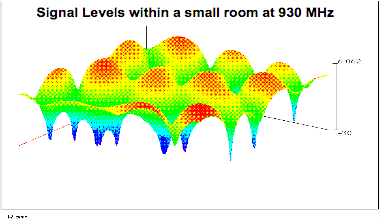

Sounds like a fun project, but be sure to learn about "multipath interference", which affects signal strength for WiFi significantly. Multipath affects the RSSI value a lot over movements of the receiver on the order of a wavelength. You can get very deep nulls if there is a strong reflection nearby that cancels the main signal at your receiver's location.
Also, your body absorbs WiFi signals a bit, so that will affect the receive signal strength depending on which side of your body the WiFi transmitter is located. And this also interacts with the multipath issue...
So think some about what kind of smoothing and averaging functions you might want to use with your data, to give more of an overall RSSI value. And think about how you want to handle the body shading issue -- you can hold the phone up over your head (and vertical) for example, but that's kind of awkward. You should see some of the fixtures we've used in EE/RF level RSSI testing of WiFi and other RF comm bands... :smile:
For example, here is a plot of the RSSI in a room in the 900MHz band as you move the (non-body-shielded) receiver around the room)... See the issue? :smile:
http://cdn2.hubspot.net/hub/316692/file-1500795371-png/figure17.png
3D surface plot titled Signal Levels within a small room at 930 MHz, showing peaks and nulls in colour from red to blue across the room floor area.
