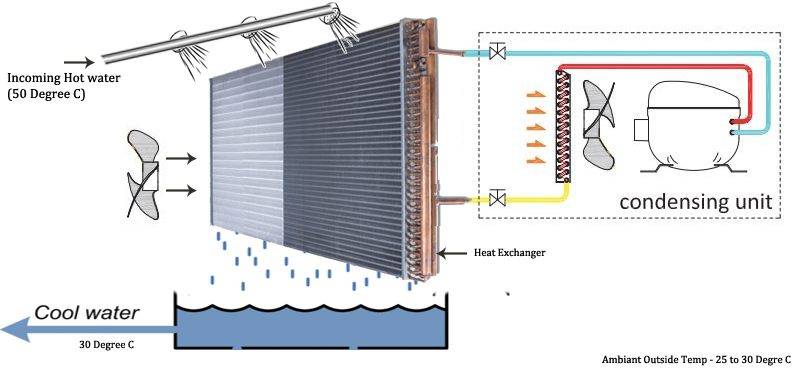

for the experiment, How about replacing the immersed coil heat exchanger with condensor fins and spray water to it at top and allow water to flow down.
see the figure below. do you think this is a good idea ?
need suggestions please. or if you have any better idea kindly help

That looks a bit more controllable to me. Something else you might consider that is still pretty simple is laying the cooling coils flat on a water-right surface and letting water run over the top of it, controlling the flow rate by changing the incline of the cooling coil.
One main goal of your design should be to be able to control and adjust the flow rate. IMO its not likely that you will calculate your way to exactly what you want, you are going to have to assess and adjust.
