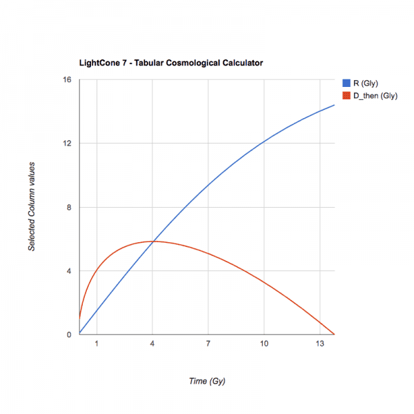

So we now have an isosceles triangle which existed at the moment of last scatter. The two long sides are about 42 million LY, and the base is the size of that "acoustic peak" resonant fluctuation.
I think this may be the complicated part of the calculation. 42 billion LY is the current distance to the point from which the light was emitted but is not directly relevant to what we see now. The light we see has only traveled ~13.5 billion LY to reach us, so maybe that is the length of the sides?
Here's what also confuses me. You can measure the apparent angular size of a galaxy and it's distance by redshift. But you cannot directly determine the size of the galaxy that way. I was lead to believe that GR/expansion requires you to adjust that apparent angular size to measure the size of the galaxy. I've read that at very high z similar galaxies actually appear larger than at lower z. There is some function of z that must be applied to the measured angle. If space is flat all along, I'm not sure what causes the need for this adjustment.

As I recall the widest girth comes at redshift z=1.6, or scale ratio S=1+z=2.6 (if people want to check using Jorrie's calculator)
CKH again,
What you look for using the Lightcone calculator is as you go back in time from present S=1 to 1.1 to 1.2,...the DISTANCE THEN (the proper distance from us back then when the light was emitted) keeps getting larger and larger. Like a cone widening out.
But when you reach S = 2.6 (corresponding to year 5.8 billion, or so) then Dthen begins to shrink back down to a point. Making the rounded bottom of a teardrop shape.
Its where the plotted curve of the Hubble radius and the Dthen intersect. When the galaxy, just as it emitted the light, was receding exactly at c, so that the light from it at first made no progress at all and only later began to make headway towards us.
You can get the Lightcone calculator to plot curves, instead of generating tables of past history. You might enjoy this if so inclined.

I just now used the Lightcone calculator to plot Dthen and the Hubble Radius R. The lightcone is more "pear-shape" than "teardrop" . The R curve crosses right at the maximum width of the light-pear.
CKH, If you want to get some easy practice with the Lightcone calculator, and see the table of numbers underlying this plot, just go to
http://www.einsteins-theory-of-relativity-4engineers.com/LightCone7/LightCone.html
and click "set sample chart range"
and change "Slower" from 0.4 to 1.0 (to get rid of a continuation into the future, which doesn't look pear-ish)
and click "calculate".
You can also reduce the number of steps down from 60 to make the table more compact. Here is what I got when I reduced the number of steps to 15.
