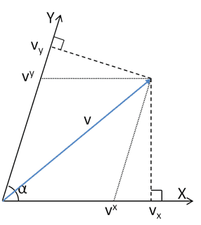

I am studying co- and contra- variant vectors and I found the video at youtube.com/watch?v=8vBfTyBPu-4 very useful. It discusses the slanted coordinate system above where the X, Y axes are at an angle of α. One can get the components of v either by dropping perpendiculars to the axes (vi) or by dropping a line parallel to the other axis (vi). These give correct results for the norm vivi and the dot product vi wi. (I have not shown w). So the vi are called contravariant and the vi are called covariant. According to the video Dirac thought this was a great example.
But both vi and vi contra-vary with a change of scale of the basis vectors. This contradicts some definitions of contravariant and covariant components, e.g. this one on Wikipedia. These definitions say that covariant components co-vary with a change of scale.
Is there a simple resolution to this apparent contradiction?
Norm and dot product were calculated by expressing vi and vi in Cartesian coordinates. Quite a lot of equations! Along the way we found the metric for the slanted coordinate system.
We can demonstrate the problem by drawing basis vectors on the diagram and then another set double their size.

The covariant and contravariant components belong to different basis vectors.

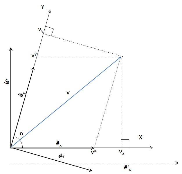

Thank you Orodruin. Cryo is a bit harder. Following Orodruin I immediately saw that I needed smaller covariant basis vectors which I call ex, ey. I realize that the up/down position of the indices is debatable. Now I have a new diagram showing a few of the basis vectors.
To get v with the covariant coordinates we must have
v = vxex + vyey . . . . . . . (1)​
I have drawn them in on the diagram and ex is clearly smaller than ex, which I have conveniently drawn so that vx = 1. We must also have
vxex = vxex . . . . . . . (2)​
and similarly
vyey = vyey . . . . . . . (3)​
which give us
v = vxex + vyey . . . . . . . (4)​
which is as it should be.
(3) gives us
vy = ey(ey)-1vy . . . . . . . (5)​
where (ey)-1 is the inverse of ey: or ey(ey)-1 = 1.
(5) shows us that vy does indeed vary with ey with a strange constant of proportionality (ey)-1vy.

Your diagram is not correct. Generally the dual basis is not parallel to the tangent basis (it is orthogonal to the coordinate surfaces, not tangent to the coordinate lines).

A vector can be written in terms of any basis with the corresponding components. When you have a coordinate system with coordinate functions ##x^a## you can introduce the tangent basis ##\vec e_a = \partial \vec x/\partial x^a## and the dual basis ##\vec e^a = \nabla x^a##, respectively. The contravariant components by definition are those components that express a vector in the tangent basis and the covariant components by definition are those that express a vector in the dual basis.
You can write ##\vec v = v^a \vec e_a## or ##\vec v = v_a \vec e^a##, but generally this is not the same as ##v_a\vec e_a##, which does not make sense because you are then creating a vector that has the same contravariant components as the covariant components of ##\vec v## in this particular coordinate system.

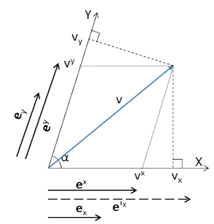

Following Orodruin's great tip
Orodruin said:
##ê^j = \nabla x^j##
(I am using ^ instead of → over basis vectors, after Sean Carroll.) Since I already knew the inverse metric of the skewed system, it was easy to calculate that
$$ ê^1=\hat x - \frac { \hat y } {\tan \alpha} \\
{\rm and} \phantom {10000000000000000000000000000000000000000000000000000000000}\\
ê^2=\frac { \hat y } {\sin \alpha} $$ where ##\hat x, \hat y## are the Cartesian basis vectors. In can now redraw my diagram (##x=1,y=2##)
##ê^x## is ##\pi / 2 - \alpha## below the Cartesian X axis. Therefore the angle between ##ê_y## and ##ê^x## is a right angle, and the projected line from ##v_y## is parallel to ##ê^x## as I should have known and Orodruin intimated when he wrote in #5 "the dual basis is ... orthogonal to the coordinate surfaces, not tangent to the coordinate lines". Likewise ##ê^y## is parallel to the projected line from ##v_x## and always on the Cartesian Y axis. In addition ##|ê^i |>|ê_i |##.
All this did not answer my original question that "both ##v^i## and ##v_i## contra-vary with a change of scale of the basis vectors". I had to use the pullback operator to find the metric of the primed system and then showed that if ##ê'_x=aê_x## and ##ê'_y=bê_y## (##a=2## in the diagram above) then
$$v'_x=a^2v'^x+abv'^y \cos \alpha\\
v'_y=b^2v'^y+abv'^x \cos \alpha$$ Which does answer the question - the transformed covariant coordinates do covary with the contravariant basis vectors.
