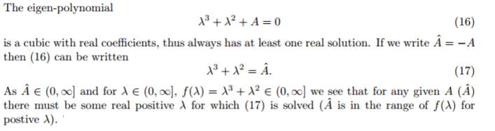

Question:
For ##\Lambda^3+\Lambda^2+A=0## , show that for ##A<0## there is some real positive ##\Lambda## which solves this
[/B]
Attempt:
Write ##-A=\hat{A} ##, then ##\hat{A} \in (0,\infty)##
and ##\Lambda^3+\Lambda^2=\hat{A}=\Lambda^2(\Lambda+1)##
Since ##\Lambda \in (-\infty, \infty) ## then ##\Lambda^2 \in (0,\infty)##, and so since ##\hat{A} \in (0,\infty)## then ##(\Lambda-1) \in (0,\infty) \implies \Lambda \in (-1,\infty)##
So this shift by ##-1## means that ##\Lambda## is not guaranteed to be positive?
Solution attached:
I understand the solution after the 'claim' ##\Lambda \in (0,\infty)##.
However I don't understand where this comes from, this is part of what we are trying to show and we only have ##\Lambda## is real?
Many thanks in advance.

Your post would be easier to read if you followed the lead of the material you posted, and used lower-case lambda (##\lambda##) instead of upper-case lambda (##\Lambda##). At first I misread ##\Lambda## as A. In TeX, the lower-case Greek letters have spellings that start with lower-case letters; i.e., \lambda versus \Lambda, and \theta versus \Theta.
Consider ##f(\lambda) = \lambda^3 + \lambda^2 + A##, with A < 0.
##f'(\lambda) = 3\lambda^2 + 2\lambda##
On what intervals is f' positive? zero? negative? On these same intervals the original function will be increasing, horizontal, or decreasing, respectively. This should give you a good idea of where any zeroes of the graph of f are.
BTW, two of the intervals in the posted image use nonstandard notation-- ##(0, \infty]##. I've always seen these written as ##(0, \infty)## when an interval extends infinitely far in either direction.
I don't think it even requires calculus. Write it as ##f(x) = x^3+x^2 -a## where ##a>0##. Then ##f(0) = -a<0## and ##f(x) > 0## for ##x>a##.
