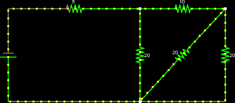

Hello everyone.
im amit, newbie in this forums, hopefully I am posting my question in the correct one.
anyways, i was trying to solve this qustion from last semester considering the attached image as a circut
with voltage source of 30V
the task was to find the current over the resistor position diagonally R=20 Ohm
My assumption was with a total equivalent current of 2A is flowing over the 5 Ohm resistor , then to be divided between 10/20 Ohm resistors and then again between 10/20 ... what gives to result of 2/3A which is ... wrong.
result is 0.5A , but why ? does it matter in which direction i consider the current flow ? how can I know which is the right direction if so ?
thanks alot, exam coming by the end of the week
cya around. amit.

You are correct with that 2A flows from the source through the 5 Ohm resistor. Now look at the equivalent resistance on both branches. Both paths have a 20 Ohm resistance (20 Ohm on left and 20||20 + 10 = 20 Ohm). So the current is divided equally to 1A each. So now that 1A flows through the 10 Ohm resistor and gets to the point where the diagonal 20 Ohm connects with the vertical 20 Ohm. Both paths have equal resistance so the current evenly splits again to 0.5A each.
The direction does not matter. In general when you solve for current and get a minus sign that just means your initial guess at the direction was wrong. The current flows the opposite way instead.
Allllright .. i think i got it now
from what i got from your answer one should always consider the total resistance when one calculate those sorts of problem, i tried to guess it each time with a specific resistor with a specific resistance and didnt consider other resistors might be connected and influencive.
now i know
Thanks:biggrin:
Amit, Germany.
