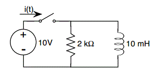

The circuit is in steady state before the switch is closed at t=0 I need to find how the current changes with time after the switch is closed.
I read that at steady state inductor behaves like a short circuit, so does this mean when the switch closes all the current flows through the inductor? If so what happens after a long time has passed since the inductor opposes change in current flow? I am really confused...

When the switch closes you no longer have steady-state. So no, the inductor does then no longer look like a short circuit.
But if the switch is left on long enough, you once again have a steady-state comndition.

Because you just flipped the switch, applying +10V to both components. Before that there was no voltage on either one.

So at t=0,
Current in the circuit = V/R = 10v/2kohms
and when t approaches infinity,
Current in the circuit = infinity? since the current won't flow through the resistor
Also, if i sum the current flow at the node (assuming all the currents are flowing out of the node)
-i(t) - V(t)/R - 1/L * Vdt from 0 to t
Does it look right?
Tekneek said:
So at t=0,
Right!
-i(t) - V(t)/R - 1/L * ∫Vdt from 0 to t
Does it look right?
That's not an equation, and it's not the total outflow of current at the node either. (I sneaked an ∫ sign in for you).
Correct would be i(t) = V/R + (V/L)∫i dt from 0 to t.

Same place you did. i(t) is the current shown in your diagram.
My equation says "current i(t) into the node = current out of the node."

Sorry i meant the i in the integral part on the right hand side of the equation.

i is shorthand for i(t).

Isn't the equation for voltage across inductor,
V = L di/dt
Then when you integrate to find the current,
i = 1/L [itex]\int[/itex]Vdt = V/L [itex]\int[/itex]dt
In your equation the current through the inductor is
i = V/L [itex]\int[/itex]i dt, i don't get how there is an i there...

The reason you don't get it is because I screwed up! :redface: You have the right expression.
So now you see how the current builds up to ∞ with time?

lol. Well, the equation becomes
i(t) = v(t)/R + (v(t)/L)*t
When t is infinity i(t) is infinity, and when t=0, i(t)=V(t)/R
So plugging in everything i get,
i(t) = 0.005 + 1000t
Thanks for everything :)
