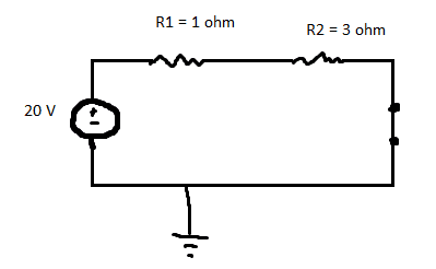

When the t < 0, the switch is open, the inductor acts like a short therefore the circuit looks like
Circuit schematic: a 20 V voltage source on the left in series with R1 = 1 ohm and R2 = 3 ohm, with a switch on the right side and a ground connection at the bottom.
The current is then 20V / 4 ohms = 5 A
Since the inductor has been in series with the battery for a long time, it is safe to assume it is fully charged? So the current across the inductor is 5 A?
Assuming this is correct, io= 5 A
If we close the switch, R2 becomes shorted, then the current in the circuit would then be 20V / 1 ohm = 20 A
So the change is in current is 20A -5A = 15A
I don't know if we need this value, but inductors resist change in current so it probably is important? :rolleyes:

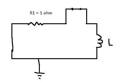

when t = 0, switch is closed and battery becomes shorted and R2 becomes shorted.
Circuit schematic of a series RL circuit with R1 = 1 ohm, a switch in parallel with the resistor, an inductor L on the right, and a ground symbol at the bottom.
Current in circuit is now 20A.
To find voltage change in inductor, we will probably need the change in current and the time for current change.
I'm guessing to find the time, we will need I(t) = Io e^-t/(L/R))
time constant when switch is closed is L/R = 0.08H / 1 ohm = 0.08 sec
20 A = 5A (e^-t/(0.08))
4 = e-12.5t = e1/12.5t
ln 4 = 1/12.5t
1.386* 12.5= 17.32 = 1/t
t= 0.0577 sec

You are asked to find i(t). Initially, the current is 5A. Long after the switch is closed, the current is 20A. You need to write an exponential equation which gives i=5A at t=0 and i=20A at t=∞.
ok, I think I found it.
i(t) = i(∞) - Δi(e^-t/(L/R) = 20 - 15(e^-t/(L/R))
Right. It can be derived using differential equation.

You have i(t) and you know R1, Us. You can get the expression for UL using
the equation UL+UR1=Us.

i thought R2 and the voltage source were shorted.
why isn't voltage source shorted? I thought it had to be shorted to find Req
You need not short the voltage source as it is clear that equivalent resistance is R1, since all the current now passes through R1. For calculation of Thevenin equivent from inductor terminals, yes you should short the voltage source but while writing expression for current or voltage, you should include it back.
i(t) = 20 +(5-20) e-12.5t
the voltage drop across R1 is still (5A)(1ohm) = 5 volts (because current in circuit is still 5A, but will increase to 20A over time) at t=0, but will exponentially increase to 20 volts over time.
Since the voltage drop on R1 is 5 volts, and the battery supplies 20 volts, the inductor must have the remaining 15 volts (at t=0) which will decrease exponentially to 0 volts over time.
so for UL(t)= UL(o) e-12.5t = 15e-12.5t

Looks good!
