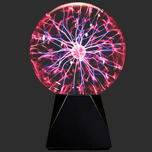

How does current flow with corona?
I am trying to understand the current path for corona. Assuming the corona appears on the high voltage electrode, how are the electrons actually flowing? I understand that with flashover a low resistance current path is created as the air is ionized but what is happening with corona?
Like with this plasma globe, where is the current going?
Corona is where the electric field gradient near a tight radius, is so steep that it tears electrons from the air molecules. Recombination of the ions emit light. But the field gradient away from that point is less, so a flash-over arc is not supported. Air pressure is important.
https://en.wikipedia.org/wiki/Corona_discharge
As that article states, "It represents a local region where the air (or other fluid) has undergone electrical breakdown and become conductive". My question is where does the current conduct to? It's easy enough to make general statements but understanding what's truly happing is tougher. So where does the current flow? If flashover is sort of an "amplified" corona that completely ionizes a channel between electrodes allowing current to flow between them, where is the current flowing without flashover? Because corona causes leakage in the system. It also can cause EMI issues so there is current flowing. I'm not understanding how. Maybe most others don't either and we just accept that it does?
So with the image above, I believe the air is being ionized and emitting light in that particular region. It terminates at the glass so the channel stops there. Since we know that corona can cause EMI issues, what is the current path? If I had sensitive electronics on the other side of the glass, what would the coupling paths be?
The local voltage gradient is reduced by the radius of the corona discharge. The circuit is closed within the corona where the ion charges recombine to be neutral, with the emission of light and heat.
https://en.wikipedia.org/wiki/Paschen's_law
If the gas pressure is very low, and the available current very much limited, there may be sufficiently high resistance in the gas to maintain the threads of arc discharge.

If I have two electrodes and start to see corona on one, there is current flow. So I'm getting from this the current isn't flowing back to ground, it's just "disappearing" in thin air as the electrons are combining with air molecules. First of all, if the molecules were originally neutral, combining with an electron would leave them charged. Maybe that doesn't matter for this discussion though.
Now let's say we have the same scenario where we have two electrodes and the field intensity is large enough to cause corona. If we increase it further, we'll eventually have flashover. But if we add an insulator, let's say glass, between, there will be no flashover and still only corona. That's because the glass has a much higher breakdown voltage than air and the localized breakdown stops at the glass. But I'm still having a hard time understanding what's actually happening. If I have sensitive electronics on the other side of the glass, are there the potential for EMI issues? if I still have the potential for EMI issues, what is the coupling path and how does the current flow from the corona in air to the device?

They were neutral. They were then ionised by the local voltage gradient. The ions then move to where they recombine, so they are neutral again.
To understand corona you must study the field gradient about a point source distant from a ground plate, not between parallel plates.
