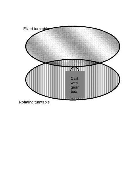

swerdna said:
By a flexible cable.
So, to be perfectly clear: there is always a direct causal link between the rotation of the propeller and the rotation of the wheel? Turing either one in either direction always causes the other to turn?

Thinks for the replies. This cart was only meant to be a prototype but it worked so well I though I would publish the results. The cart I was going to build (and still might) would have two identical carts directly opposite each other and sharing the same tether. The whole weight would be on the two wheels and no weight on the centre pivot. This design would be very balanced and would reduce and negative effects from such things as the turntable not being perfectly level and centre pivot friction.
I’m just a backyard inventor so don’t tend to get too technical. But here are a few basic specs . . .
The wheel is 8.5cm diameter
The circle traveled by the wheel is 120cm diameter
The prop is 12 x 6 slow air
Shafts run on roller bearings that have been washed of grease
Cable is from my son's BMX brake system
Hose clamps are optional
Here’s a mug shot . . .
Yes.
  • #34
swerdna said:
Yes.
Thanks. It's also more obvious in the nice close-up shot. The workmanship does look excellent, incidentally.
I take it the diameter of the table is 48 inches. What is the diameter of the hole in its center? The table is mounted on a bicycle wheel, is that correct?
  • #35
Centre hole is 22.5 inches and table diameter is 48inches.
Yes it is simply attached to a bicycle wheel. Thanks but I don’t think hose clips qualify as “excellent workmanship”.
The shafts are threaded rod and the cable is attached to their ends by cutting a thin slot down their diameter, spreading the two halves apart, inserting the cable end then and then closing the slot by winding a nut up the thread to squeeze the cable (my son’s idea).

Phrak said:
What are thrust speed and advance ratio?
Thrust speed is the speed of the air through the propeller. Advance ratio is the ratio of speed of the air through the propeller divided by the speed of the ground (relative to the cart). Another way to look at this is the distance the prop would move forward for every revolution of the driving wheel, this is equal to effective prop pitch / (gear ratio x wheel circumference).
swerdna said:
The wheel is 8.5cm diameter. The prop is 12 x 6 slow air
Prop pitch is 6 inches per revolution, wheel circumference is 10.5 inches. Advance ratio would be < (6 / 10.5) < .57 depending on the ratio of effective pitch / physical pitch. The prop also has an advance ratio, (actual air speed) / (prop surface speed), and the effective pitch is the (actual air speed) / (rate of rotation of the prop). The physical pitch of the prop advances 6 inches per revolution, but the air flow through the prop will be less than 6 inches per revolution.
I've simplified the prop advance ratio description, as the real thing is a bit more complex. The prop operates in it's own induced wash, and in the imediate vicinity of a typical propeller, there's little change in air speed, mostly just an increase in pressure. Normal prop wash pressure is higher than ambient, so the air continues to accelerate aft of the propeller until it's pressure returns to ambient. The speed of the air at the point when it's pressure returns to ambient is called the exit velocity. For a typical propeller, the air speed through the prop is the 1/2(ambient speed + exit speed). I not sure how much difference there is between effective pitch and actual pitch for the DDWFTTW models, other than it's probably small.

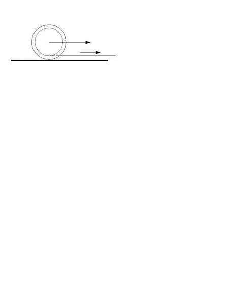

Powered by the difference between wind speed and ground speed. The DDWFTTW carts use the wheels to drive a prop to generate a small amount of thrust to oppose the tailwind, allowing the cart to go faster than the wind. The speed of the thrust is a fraction of the speed of the wheels, and this effective gearing multiplies the thrust at the prop so it's larger than the force at the wheels, minus some losses in conversion of power. The speed reduction factor is greater than the thrust muiltiplcataion factor due to losses, so power output is less than power inputs, meaning it's not a perpetual motion machine.
As a though experiment example, imagine a cart with an advance ratio of .5, the thrust from the prop is 1/2 the speed of the ground (wheel) speed. At 10 mph, the prop produces 5 mph of upwind thrust. With a 10 mph tailwind, perhaps the cart could go 12 mph forwards, producing 6 mph of upwind thrust to oppose the tailwind, but using up 4 mph of the "excess" thrust speed to overcome the drag factors.

No, the ground is also part of the power source. If the ground were frictionless, then the cart would just slide along at the same speed as the wind.
All wind powered devices have to "slow" down the wind in order to extract power from it. The DDWFTTW cart is designed to be able to slow down the wind with it's propeller, even when the cart itself is traveling somewhat faster than the wind.
Requirements: The thrust speed from the propeller must be greater than the apparent headwind experienced by the cart in order to overcome the overall drag and go DDWFTTW. The power output at the air + propeller interface must be less than the power input from the ground + wheel interface (otherwise the excess power consumption could only occur from deceleration of the cart).
"Advance ratio" as used for DDWFTTW carts is ultimately the speed of the air through the prop divided by the speed of the ground at the wheels. It can be approximated by noting the prop pitch (advance distance per revolution), gear ratio, and driving wheel diameter. The advance ratio has to be < 1 for a DDWFTTW cart. The advance ratio is also an effective force multiplier, after losses.
With an advance ratio of .5, prop speed is .5 of the wheel speed, and perhaps prop force is 1.4 times that of wheel force (70% efficiency). With a 10 mph tailwind, and with the cart traveling at 10 mph, the prop speed is 5 mph, and the cart is operating with zero apparent wind. The prop thrust is 1.4 times greater than the opposing force from the driving wheels, enough in excess of the overall drag, that the cart acclerates into an apparent headwind condition. At 12 mph, the prop speed is 6 mph, but the apparent headwind is 2 mph, so the prop only acclerates the air by 4 mph (idealized situation here). The thrust and corresponding opposing force from the driving wheels will be reduced, but the overall drag will increase, and eventually the cart reaches a terminal speed when forces cancel (total thrust = total drag).
With 100% efficiency, the maximum speed of a DDWFTTW cart would be wind speed / (1 - (advance ratio)). An advance ratio of .5 would allow double the wind speed, an advance ratio of .75 would allow quadruple the speed. However 100% efficiency isn't possible. Prop efficiency is 85% to 90%, and there are loss factors due to drivetrain efficiency, rolling resistance, and aerodynamic drag. The actual maximum speed of a real DDWFTTW cart will be faster than the wind, as seen by the videos, but I doubt it's possible to achieve double the speed of the wind, mostly because of prop efficiency issues.
Note that iceboats are a type of sailcraft that when heading at an offset to the wind, can achieve speeds where the net downwind speed is more than double the wind speed. The sail is able to divert the apparent wind so that the upwind component of the diverted flow is faster than the iceboats net downwind component of speed. Note that the primary (non-drag related) force from the ground is perpendicular to the direction of travel of the iceboat, but directly opposes forward motion of a DDWFTTW cart (unless you pair up 2 constantly tacking iceboats via a long connector and call that a DDWFTTW cart), which is why I believe that a iceboat or landsail will outperform a typical DDWFTTW cart.
