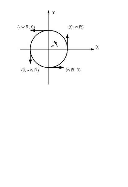

v_cart = v_wind, we have:
F_tot = rho_air x S x K^2 x v_cart^2 -
... rho_air x S x K x ( (K^2) x v_cart^2)
= rho_air x S x K^2 x (1-K) x v_cart^2
Now, if K < 1, indeed, we see that we have a forward force, while if K > 1, we have a negative force (You were right, Jeff).
