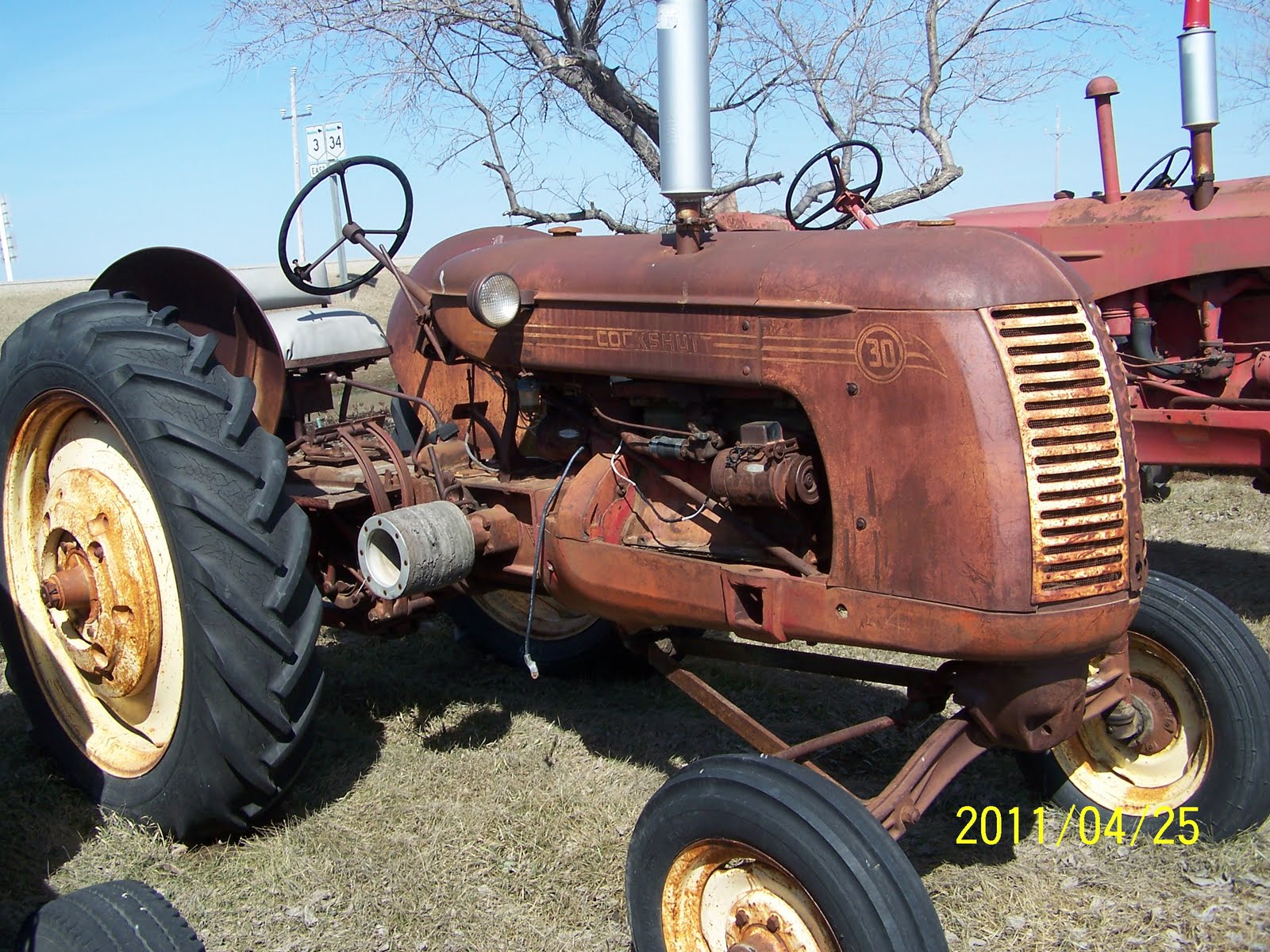

here's a funny story.
We had a Cockshut tractor that was used intermittently in the warmer months.( front end loader )
The battery was never left on a trickle charge when not in use, and was stored in a non-heated garage over the winter.
To start the thing up, the battery was put on a charger, then attached to the cables, and never failed to give the old girl a go.
I do not recall ever my father having to buy another battery for that machine.
6 v battery if I recall correctly.
http://2.bp.blogspot.com/-6-Ec36DZfEc/TbY7WJMQI5I/AAAAAAAAAMU/b772S55PRXk/s1600/100_9560.JPG
Not quite as rusty as that, although the paint was faded.
It had a PTO and the thing sticking out is for a belt drive - good for running the wood saw.
The belt had to have a twist put in it, else the saw would would run backwards.

I do wonder if that battery would still be in, or could still be put into operation.
Tractor probably not as the HP is enough to cut it these days.
